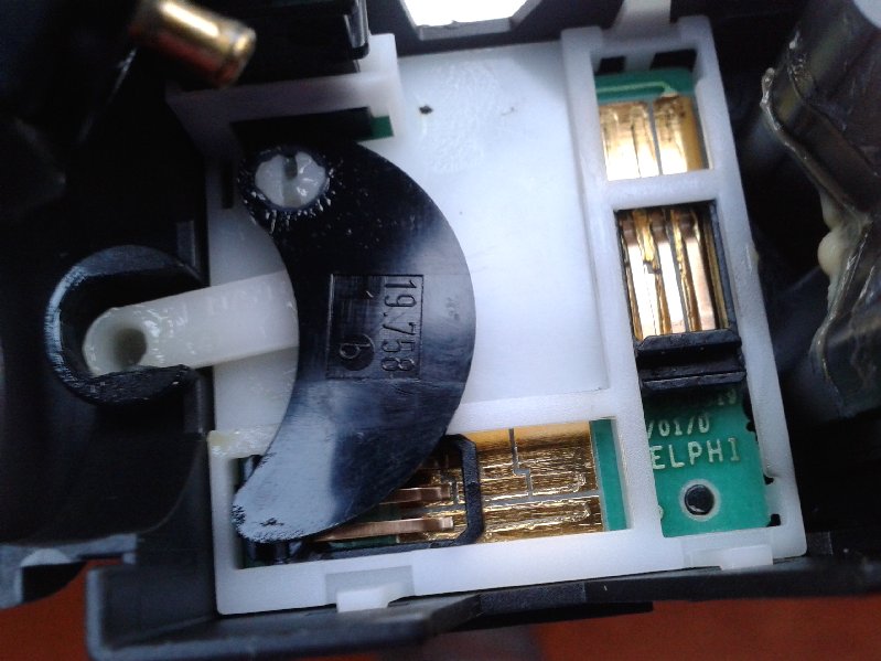

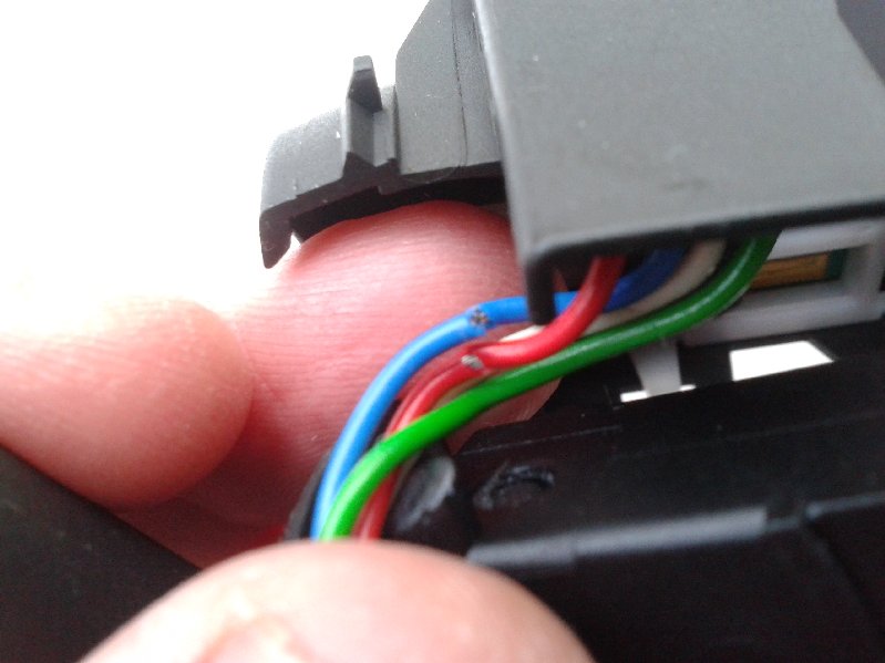

police666, my battery is not the best as you remember, however I have taken the stalk off which is a right PITA. How many screws does a Jag need to hold the column cowl in place?
I got the stalk apart and it all looks OK inside, but as soon as I connect it back up to the car and wiggle it, the lights issues start. It does appear to be the stalk that's at fault.
Looking closer, I could see that the red and blue wires inside the stalk were cut, but not broken.
Heres were it gets odd. When I disconnected the stalk, the side lights stayed on and they only way to get them off was to disconnected the battery.
There is not enough wire showing to solder these wires, so it looks like a new stalk, but why did the sidelights stay on? Even with the stalk disconnected.

Patched the wires and all works again. The original wires in the stalk are routed in a way that will break them in time - great design.
