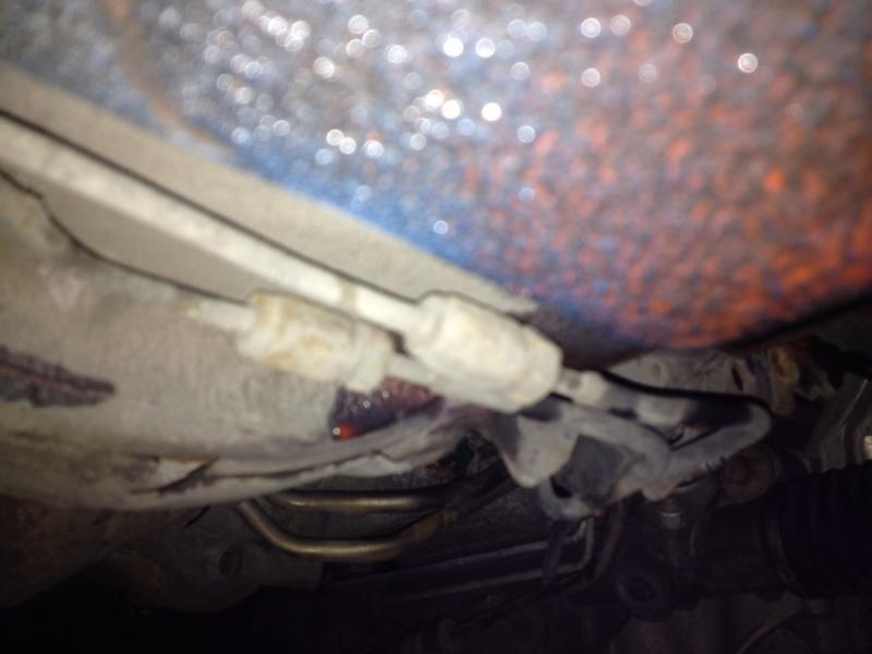

need some really sound help please,
after collecting the jag from having headgasket replaced i noticed it was loosing coolant, took it back to garage who couldnt find any leaks.
took it back a day later as io noticed this under the car near driver wheel arch
( just behind drivers wheel)
eventually they told me i had a crack in expansion bottle and it was replaced at a cost of £160 and i was told its all fine now.
got home tonight and looked under the car
im so pi***d off!
Attached Thumbnails need help, coolant leak-1ab8e589-fc96-4948-a507-fb86b7d1f8e2-5662-00000346651eee20.jpg   need help, coolant leak-cbf2c9ba-1ea2-4dca-ad22-371dfe4f2e64-5662-000003465f15cb89.jpg

thanks man, im not sure what to do,
i have marked the expansion bottles level with marker pen so i could moniter that to be sure its deffo leaking.
The second picture, could it be coolant they spilt when they topped it up?????
also how would i know if it was heater matrix??
so fed up with this jaguar at the moment, hard to belive a car can be this poorly made!

Monitor coolant level. Perhaps all is well. Dry underneath, shine an LED flashlight in the engine bay looking for coolant leak from hose, etc. Drive and see if coolant reappears. If no, it's a go, if not, bring it back. You're close to a repair. Hang in there.

Get the garage to add some UV dye to the coolant and wash the engine bay off. Then inspect everything with a black light with the engine running and up to temperature & pressure.

Just PlayIng a waiting game at the moment.
The garage have assured me there is no leak. But they didn't fill me with confidence when he said every car needs topping up sometimes.
We all know the cooling system is sealed and shouldn't loose fluid.
When it was on a ramp today having the exhaust looked at I couldn't see any drips
So fingers crossed.
