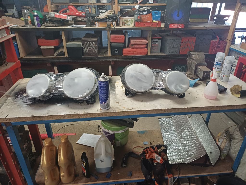

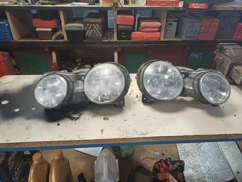

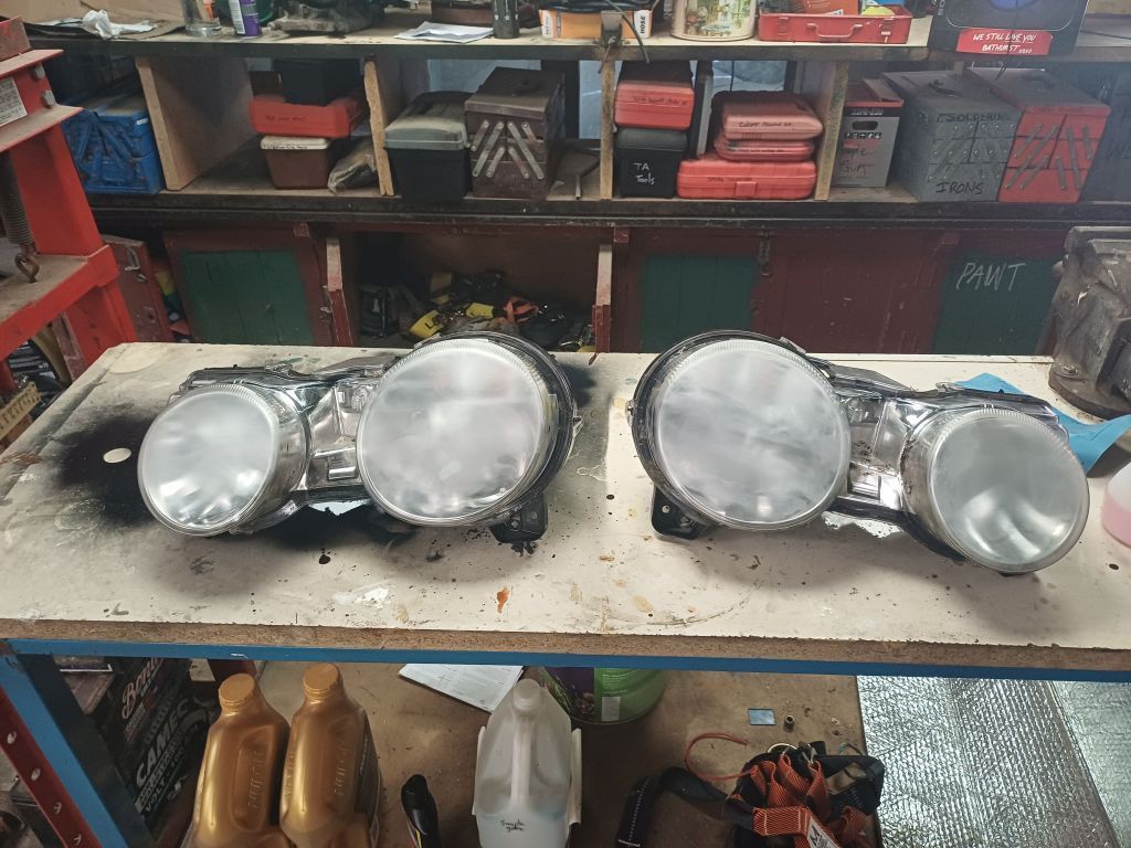

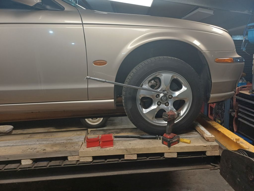

So first job to get this car its roadworthy (or warrant of fitness maybe?) is the headlights. I figured it would be easier to remove them. That is actually involved as you have to find all the hidden fasteners. The bumper has to come off which means the wheels. Well I chucked my little impact on the nuts that will undo the 27mm range rover wheel bolts... and it wouldn't touch them. So I moved onto a 1 meter long breakers bar.
Holly crap ..... what brain dead moron tire fitter put these wheels on. I gave up and dragged out my 3/4" monster rattle gun (used for crank bolts and driveshaft bolts ... designed really for trucks). Even it rattle for a second before spinning the nuts off How in the hell would I have got these off on the side of the road if I got a puncture!!
After spending 10minutes trying to figure out how to remove the decorative covers on the wheel nuts that is. What brain dead moron thought putting a layer of tin foil on a nut was a smart thing to do. I'm guessing we chuck these to the ******* and fit proper wheel nuts before that outer layer fails?

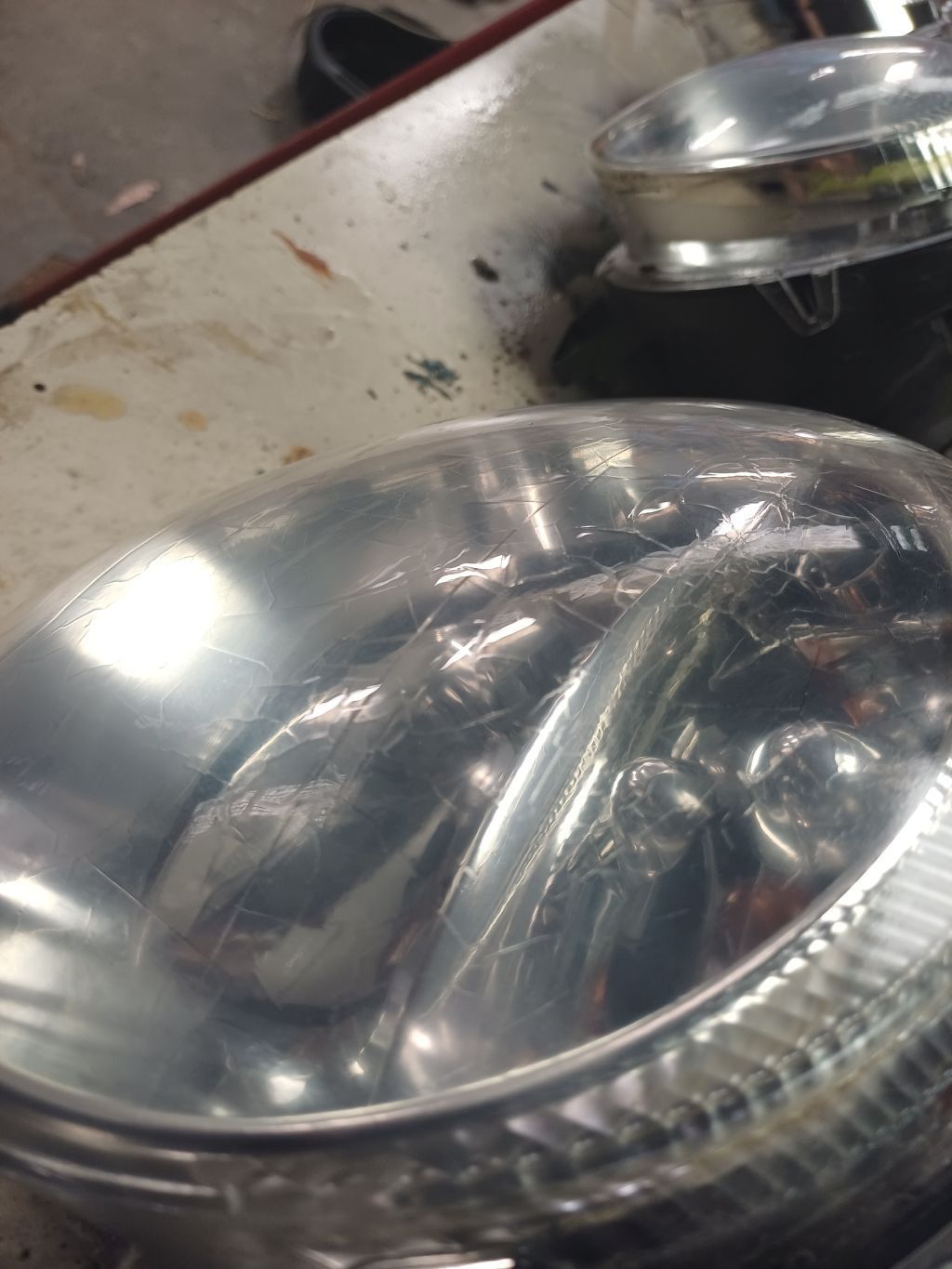

I've refinish headlights before, just working up through the sandpaper grades and polishing them. This time given the effort to remove them , I figured I'd coat them with clear so they'd last a bit longer.
sanded with 400grit
then 800 grit. I needed to keep reminding myself not to go finer so the clear would have something to grip too.
I googled the clear to use.... and one of the youtube videos had good sucess with rustoleum clear. Yeah, don't do that. After 5 minutes it reacts to the plastic and turns to ****
Don't use this stuff. I googled "plastic headlight paint"
https://www.repco.com.au/car-care-pa...QaAkg3EALw_wcB
and this isopon clear popped up, and the reviews said it was good for headlights. So I whipped into the store to grab some, the guy behind the counter said "Yeah mate, I've used it on plastic headlights its good stuff"..... I said I tried the rustoleum clear ..... "No mate, don't use that is crinkles up" ...... damn it, why didn't I come to this place first

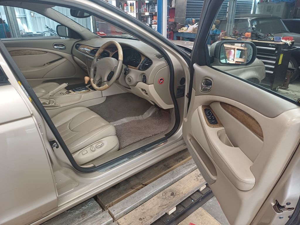

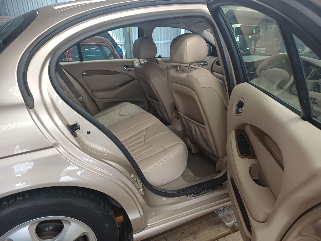

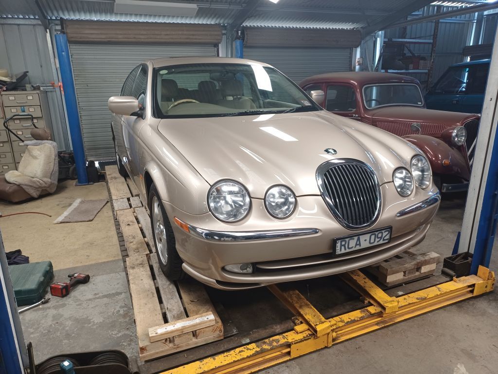

Here's some pictures of the car in questions. Its in remarkably nice condition for a 25 year old car

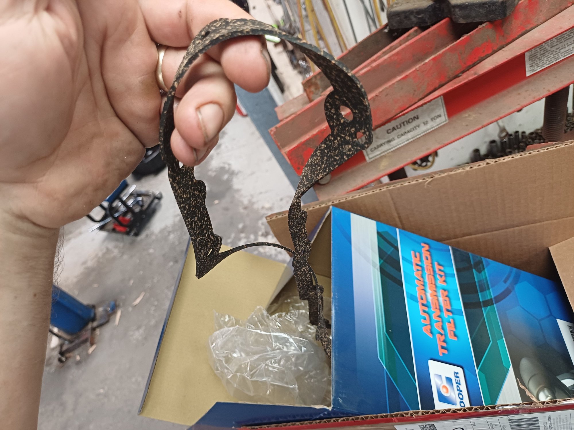

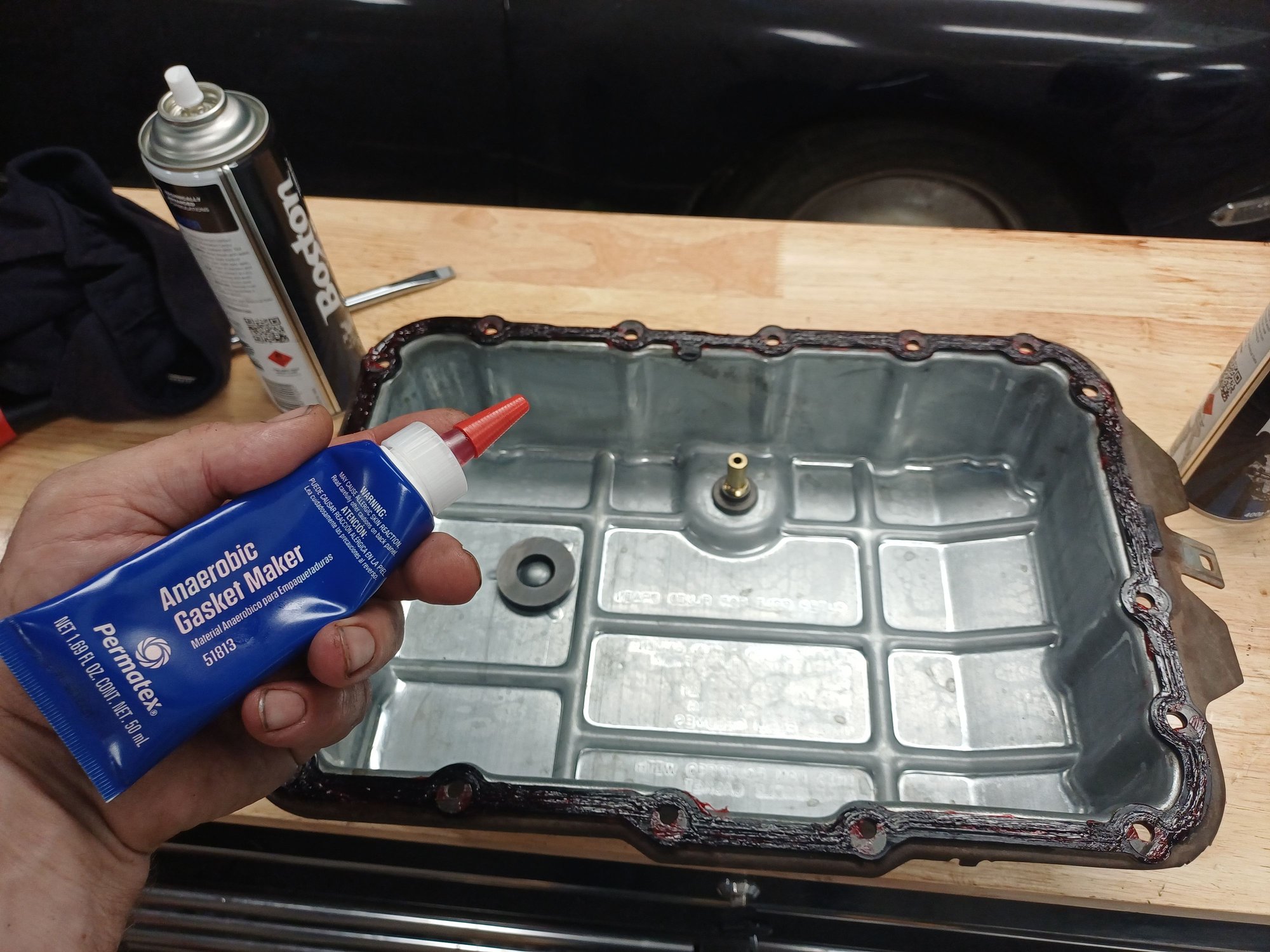

Thanks for the link to that ford gearbox link.
I did change the fluid and filter yesterday. I didn't bother draining the torque converter. Instead the next two times I change the engine oil, I'll just change the gearbox oil as well. I think I'm not having any of the problems that I find when I search on this forum as the car has never been driven on salty roads. There was no problems removing the level plug or removing the pan on the slugomatic gearbox.
That's actually looking pretty good to me. I must admit, the slugomatic gearbox was my biggest concern with buying this car. All of my cars have proper manual gearboxes, I just couldn't find anythign with a proper gearbox though.
Urgghhh.... it fits, but I dont think this cork gasket is anywhere near as good as the crusty 25 year old rubber gasket (with built in shims to prevent crushing).
So I just coated the existing gasket with some goop. Its not silicon and will not effect the gearbox at all (anaerobic sealer will just wash away). If it leaks, I'll chase up another gasket with those small metal shims around each bolt hole.
I just did a lap of the street and pulled the level plug, I didn't want it hot as I'm not keen on getting burnt by hot oil

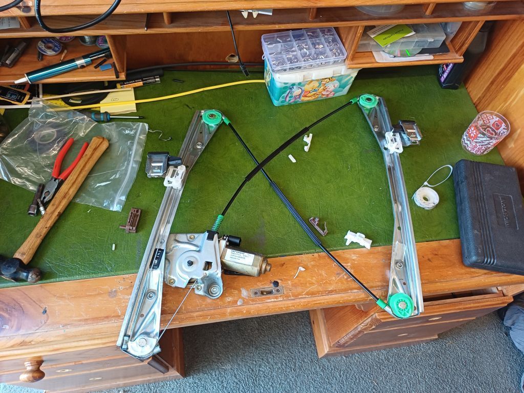

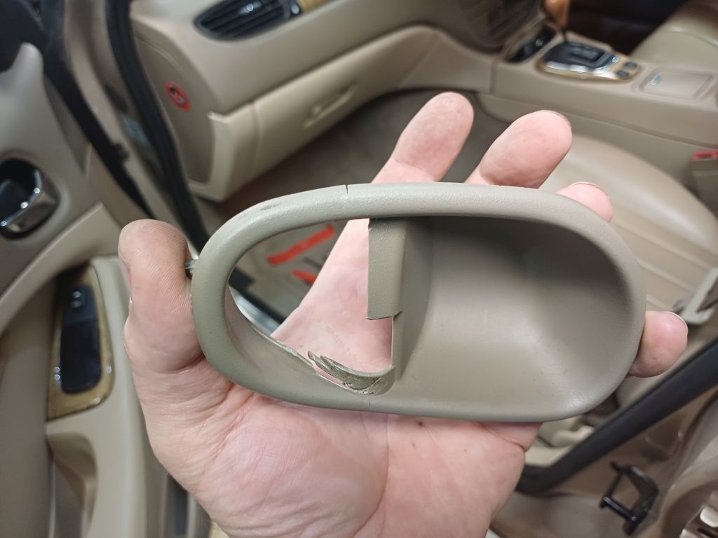

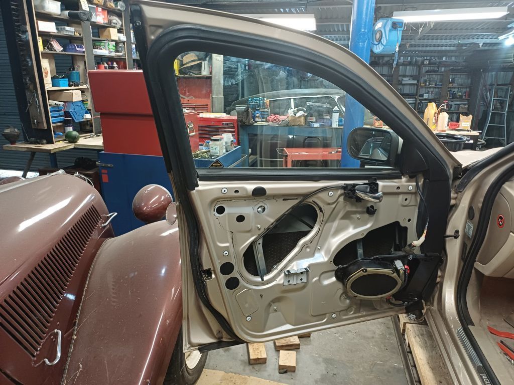

So I ordered in one of those window winder repair kits.
How in the hell do you get this out without breaking the damn thing. I think it was partially "pre-broken" for me
The repair kits are only pocket change. They arrive with no instructions and a bunch of cable and crappy plastic clips .... I figured there wasn't a snowmans chance in hell that I'd work out how to fit that. I couldn't find any instructions online either. I was quite amazed when I managed to just copy the broken mess that was there and fit the new cables and plastic (junk) brackets.
Only once repaired, the window was tilted heavily and couldn't close. Closer investigation show the cables must be wrong. See how much higher the bracket needs to sit on the cable.... hmmm. So I hit up google and remarkably found they aren't massively expensive new. Then rapidly found out the 2001 car here, has a different winder mechanism, only available online from the USA. So will take quite a while to get here .... normally I wouldn't care, but I don't want to have this car in the last owners name for extended periods of time. Anyway, I was thinking about this, and thought "why don't I just add another lug on the cable ?? ....., I measured how far out the clip was sitting and it needs to be exactly 30mm higher. So out again with the mechanism for the 3rd time.

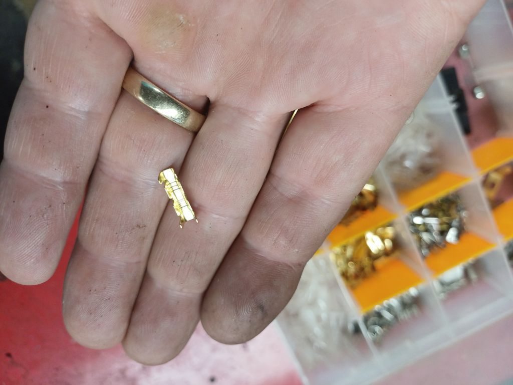

I figured I wouldn't be able to "blob" solder on is it would either break off, or flow down the length of the cable making it rigid.... hmmm.... I found this wiring crimp on joiner, if I cut it in half its the right length.
So I marked 3cm down and found it only crimp on very loosely, but I was only after the "bulk" on the cable it would offer.
It gave me something to solder on, using a nice hot iron ( a superscope is ideal) I soldered that sucker on. That should stop it moving.
and was rewarded with one perfectly working passenger front window
