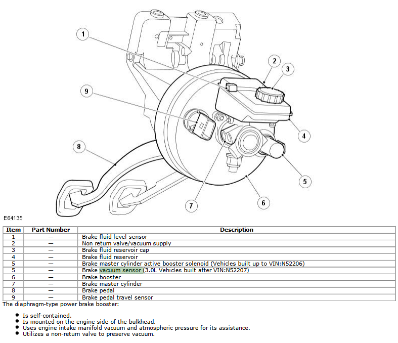

06+ V6s have a vacuum sensor on the brake booster that the V8s don't need, it ramps up line pressure in low vacuum. 99% chance it's gonna need a booster, you might be able to take the sensor out and swap them from the used to the new but be ready to do the full job.
either way get a better scan tool that can read the DSC module next time. thinkdiag mini is cheap will read all modules

Originally Posted by xalty
06+ V6s have a vacuum sensor on the brake booster...
Wiring diagrams here:
JagRepair.com - Jaguar Repair Information Resource
See figure 05.1. I think this sensor is called the "DSC Vac Sensor" in the wiring diagram, shown near the bottom of the page. Note how this sensor has two channels. Not sure of the logic that turns on the warning message, whether one or both channels out of range, but it wouldn't hurt to compare the channels.
In the workshop manual (same link as above), see page 446 of the PDF. The diagram shows the sensor as item #5, now called the "brake vacuum sensor":
At the very minimum, make sure the connector is clean and secure.

Thank you, Karl. I'll have a look, removing the connector/cleaning with contact cleaner and replacing..then crossing fingers and all else. Wonderful to have this now saved resource. Thank you very much.
