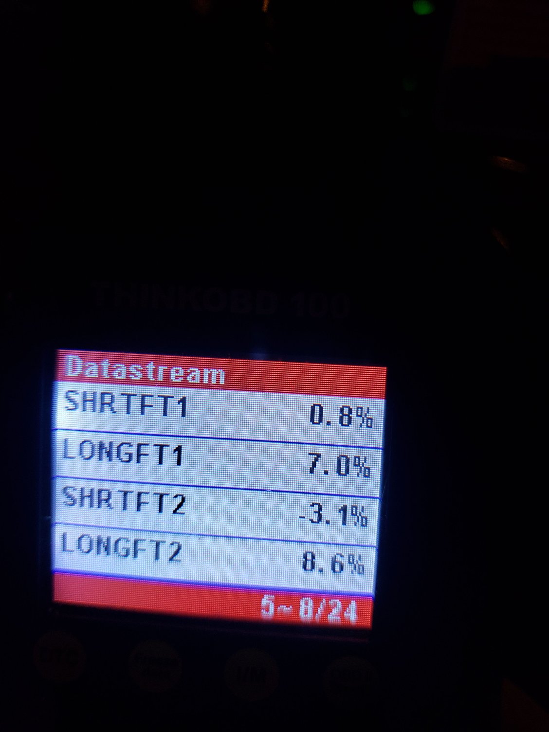

Idle is 700 in park but about 660 when stopped idle in drive. Anyone know if this is normal?
fuel trims here at idle

Might be - but those LTFTs are too big.
If they drop when you rev, look for an air leak.

Yup when I rev her up the trims drop to about 6 from double low digits. Where do you think the air leak is coming from?

No idea, lots of possibles that's why the other posts describe what to do.
6 is still quite big.
650 rpm sounds right.
Your LTFT's are wayyyy to high. Check for vacuum leaks that are common to both banks!

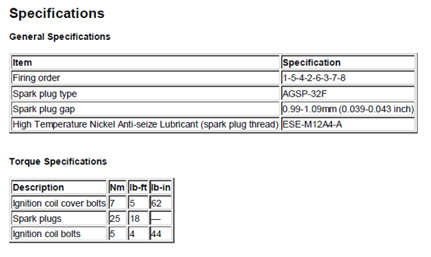

Ignition system specifications for the 4.0 litre engine from the X200 Workshop Manual:
Be sure not to over tighten the coil unit screws or the brass inserts in the cam covers will come loose.
