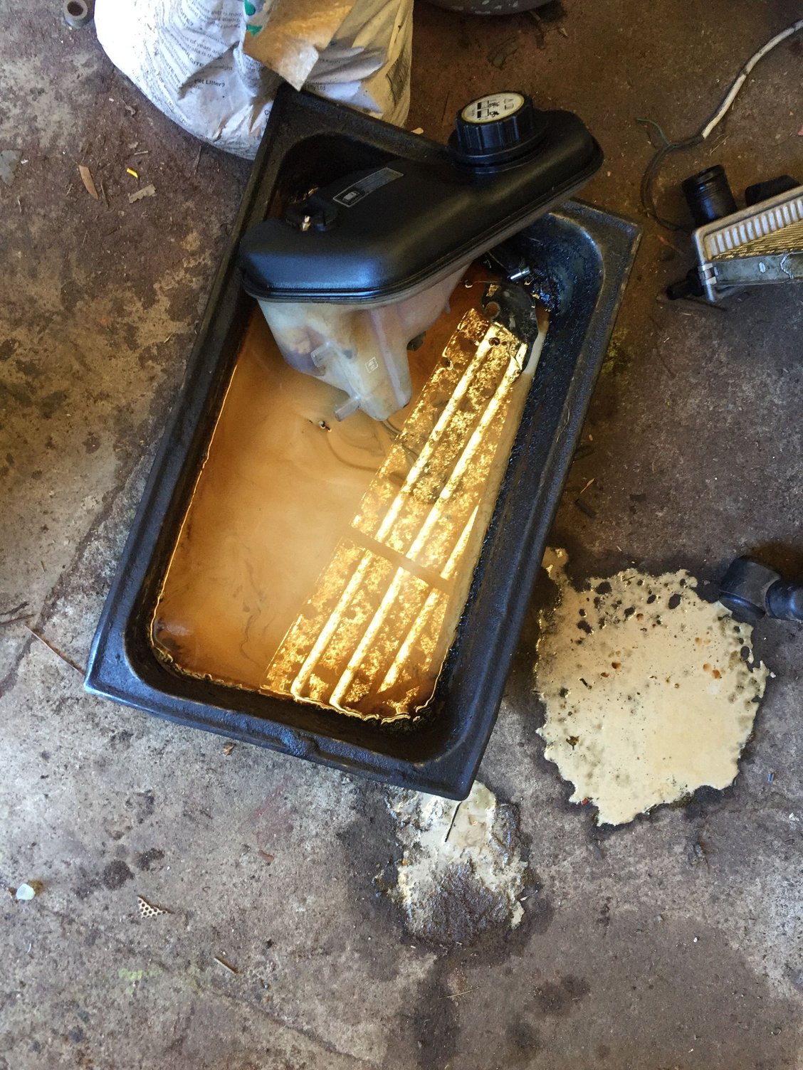

his is what came out of my radiator and top tank

Oh damn. Ya thats bad. Could be the trans cooler leaking in the radiator. If the oil looks good and not brown gray milkshakelike then check your trans fluid.
as for the radiator, it should come tight out the top once you disconnect the lines hoses fan and mounting bolts. Its not attached to the ac as far as I recall
