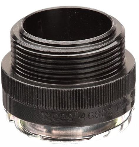

There is an adapter for the pressure tester. It cost me about $30 and will work on a lot of different late model top tanks. This is from Amazon and looks a bit different than mine but their fitment guide says it's the correct one.
