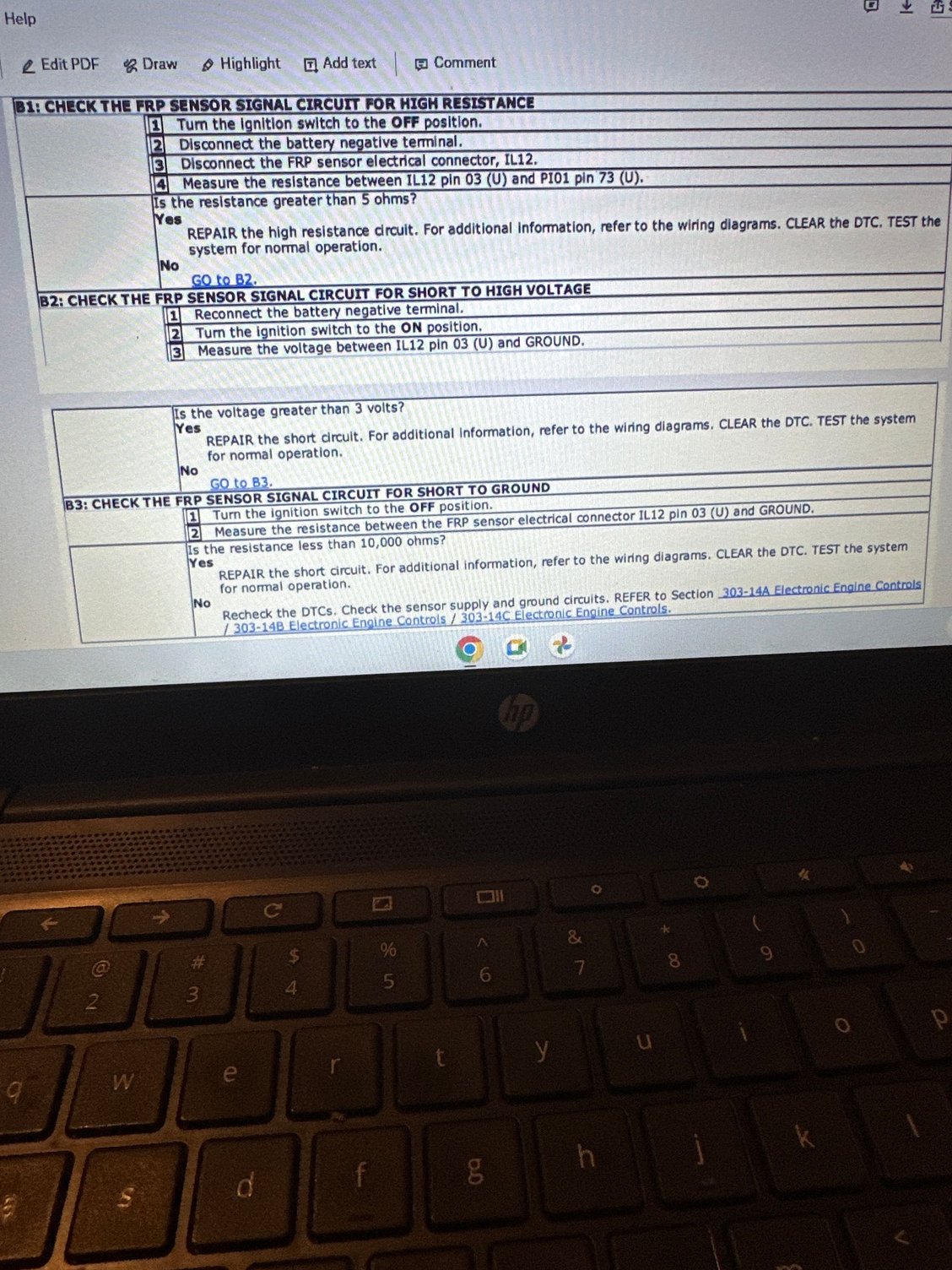

Does anyone know where pin 73 on EN1 is located? My FPR sensor tests ok. The signal wire pin has 5v switched on and the resistance on pin 2 to ground is in spec so that leaves pin 3 to check and it says check it to pin73 on EN1. If anyone can help with that it would be much appreciated. Thank you.

Ok well I was able to check continuity from the harness pin 3 to ecu pin 73 and it was fine, although harness pin 3 to ground had only 5k ohms resistance and was supposed to be at least 10k ohms. So I rewired that wire and everything is still the same sadly. The resistance is exactly the same at 5k ohms and the problem persists. I don’t understand what could be causing this.
Can you please elaborate where you are getting these test procedures? Are these the pinpoint tests from the Field Service Manual? I’m not sure how you’re supposed to see 10k ohms of resistance in a wire run, so there must be some component in the circuit responsible for that.

thanks for the info on the fuel pump. And yes these are from the FSM workshop manual. It shows on step B3. I mean I have a parts car I could switch the fuel pump over but I think this is more of a wiring issue. Or maybe ecu could be damaged. I have an auto ecu maybe I could try it to see if the fuel pressure gets corrected although I’m guessing it may throw auto trans related codes.

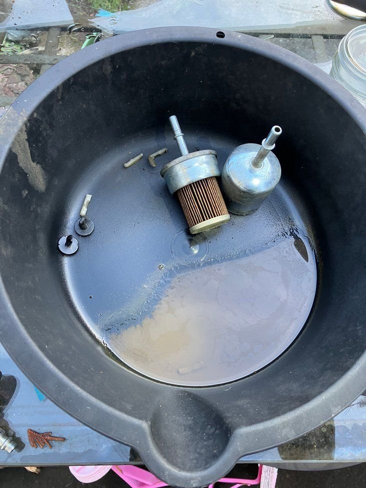

You had previously mentioned you didn't think the filter was responsible, but I'd change it anyway. It that's not it, I won't feel the least bit bad because changing the filter is routine maintenance. For giggles, use a pipe cutter and open the old filter for inspection. You might be surprised what you'd find. For example, here's what I found when I cut open the old filter on my '02 V6, maybe three years old:
