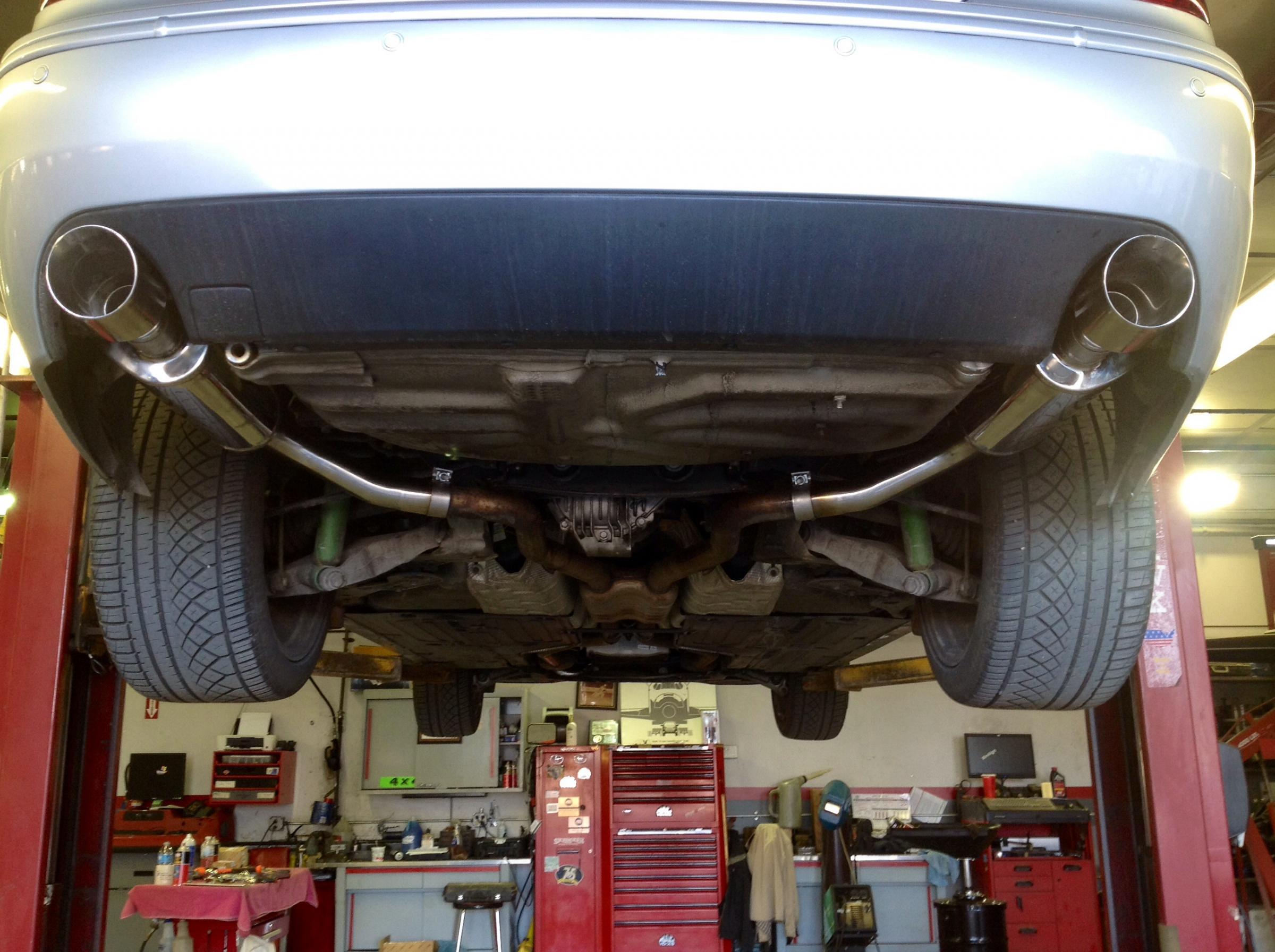

Modified where it clamps for better sealing:
Attached Thumbnails P0420 & P0430 After Mina exhaust install:-image.jpg
Old Apr 13, 2014 | 07:57 AM
Wuzupez's Avatar
Posts: 419
Likes: 19
From: NY
After:
Old Apr 13, 2014 | 07:58 AM
Wuzupez's Avatar
Posts: 419
Likes: 19
From: NY
The end!!!!
Old Apr 13, 2014 | 01:20 PM
JagSTR2004's Avatar
Joined: Jul 2013
Posts: 422
Likes: 106
From: Wales, United Kingdom
That's a nice looking system, I just received an email from Chris quoting me a price shipped to the UK. I was gonna go for it before I worked out the taxes I'd have to pay when they arrived. Looking at those pictures are giving me second doubts haha. Hope you get the problems sorted soon
