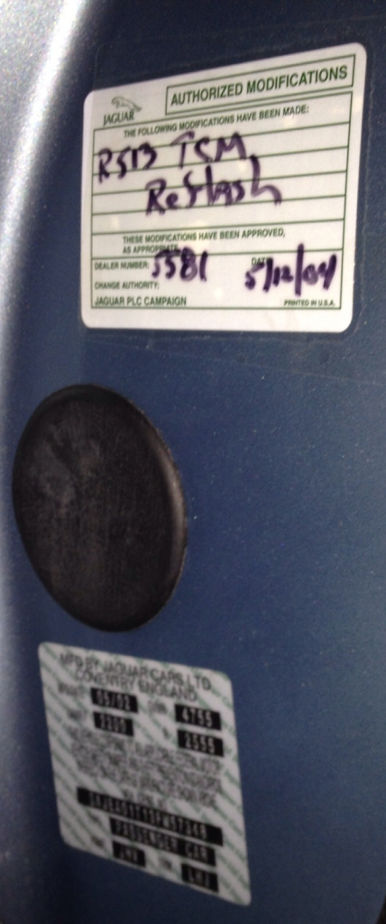

I was looking for the mfg date of my 2003 S-Type and I noticed this sticker, the one at the top.
Does anyone know what this means?

http://www.jagrepair.com/images/TSB/...0Selection.pdf

It has, that's what the sticker is.
