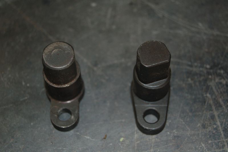

The 4.0 S-Type crank lock tool is DIFFERENT from the XJ/XK 4.0, all other tools are the same.
The crank is NOT TIMED AT TDC. It is timed at 45 degrees AFTER TDC.
The cams are then locked with the 'flats' up and parallel to the head.
Here are the 2 crank lock tools, the S-Type AJ28 is on the right.
bob gauff
