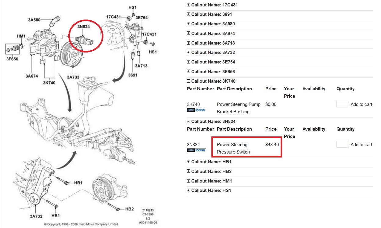

I had the same leak on my wife's 2003 Lincoln LS. Changed the P/S pump first but that was not it. Put the old pump back on. The leak was coming right out of the wires. The pressure sensor had failed internally.
Looks like there are two switches depending on your setup. One switch on the P/S pump.
Like this:
Here is the one I had leaking. It's in the steel section of the pressure hose. Does not look like Jaguar has this separate from the hose assembly. But you can use Ford #XW4Z-3N824-AA about $40-$50.
Here is what the switch looks like.

That's the beastie - number 5. My local Ford/Jag/Lincoln dealer out here in Abu Dhabi said that it wasn't easy to get hold of parts for such an old car (2001 S-type!) but he can get it from the US for the equivalent of $62 including shipping but that it would take 2-3 weeks.
