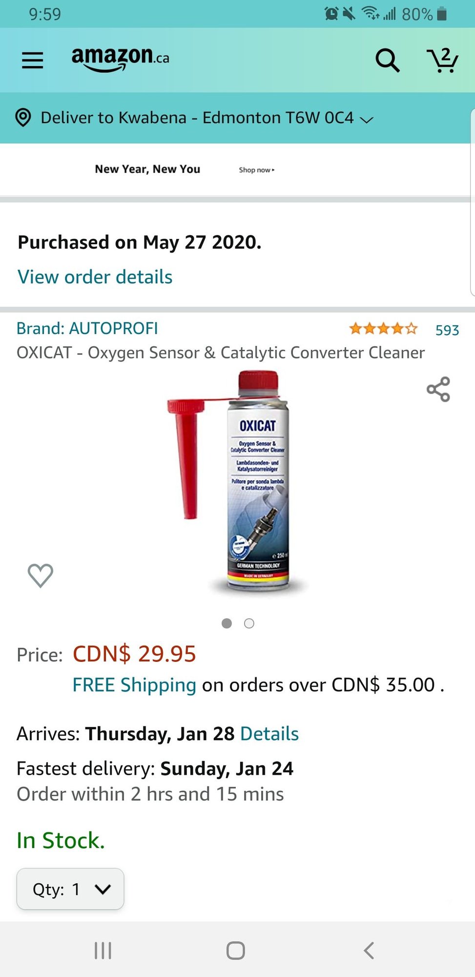

I've tried the cat clean and still the same problem
