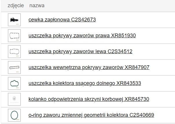

Its my check list, should i add something else?

Old Jan 10, 2019 | 02:03 PM
NBCat's Avatar
Posts: 6,068
Likes: 2,983
How many kilometres are on the vehicle?
Spark plugs - C2S46895 X 6
Coil units are VIN-specific and should be replaced with spark plugs, especially on Bank 1 due to position of the upper inlet manifold.
Upper and lower inlet manifold gaskets are VIN-specific and six are required of each.

Old Jan 10, 2019 | 02:25 PM
NBCat's Avatar
Posts: 6,068
Likes: 2,983
Ignition coils C2S42673 X 3 or X 6.

i will start with this things u write, thanks guys, if u got another idea's what i can do just write i will check it
