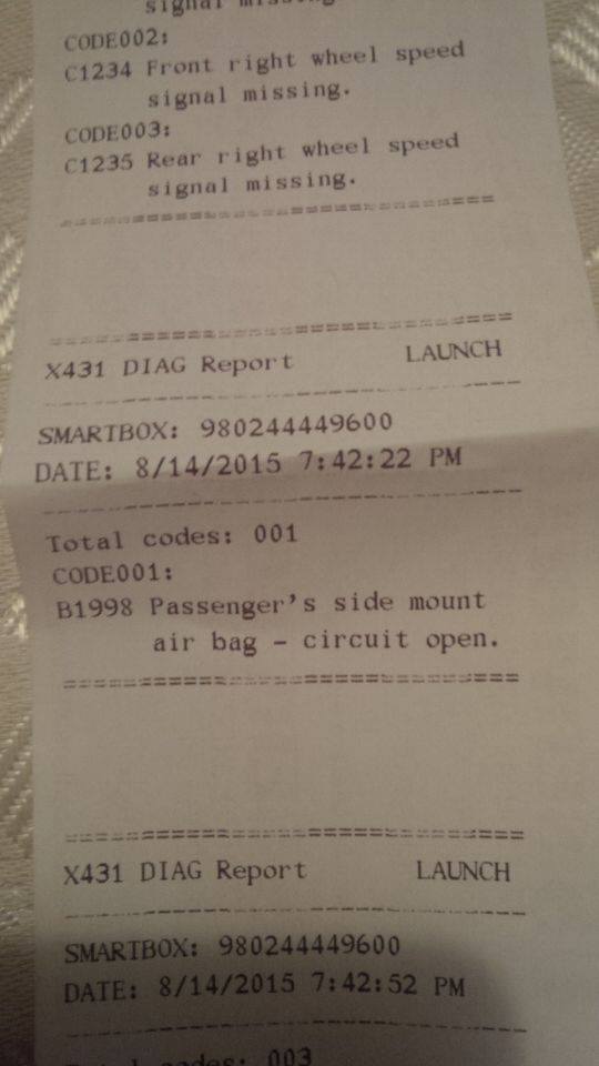

I've got a 99' S type and chagned the gear oil.
Now I started having problems with it , if I leave it for like 4-5 hrs it won't get in R or D only if I keep it at kick-down for like 40-50 seconds and it suddently enters it.
I'm uploading a video now with it and got a tester, I'm uploading the photos and the video with how the car's behaving.
I've got a 5-speed automatic 5r55n
F0-5r55n-00030
I've bought the oil and filter for the original Jaguar S-type 99' gear, wich is not this one and the filter didn't fit, so I couldn't change it and the oil apparently worked.
Any kind of help would be really apreciated!
EDIT: I also receive the Gearbox Fault and Engine Failsafe mode errors from time to time
Attached Thumbnails S-Type 99' problems, need help urgently-11911484_1625792901027914_1565395712_n.jpg   S-Type 99' problems, need help urgently-11911004_1625792904361247_1738961656_n.jpg   S-Type 99' problems, need help urgently-11903573_1625792897694581_2037061137_n.jpg   S-Type 99' problems, need help urgently-11897153_1625792887694582_830702425_n.jpg   S-Type 99' problems, need help urgently-11880824_1625792894361248_157856994_n.jpg

also with all of those codes showing I would check Battery voltage just to be sure?
Battery was dead when I bought the car

I am not sure what is going on but my first thought is to have the battery tested for proper voltage.
