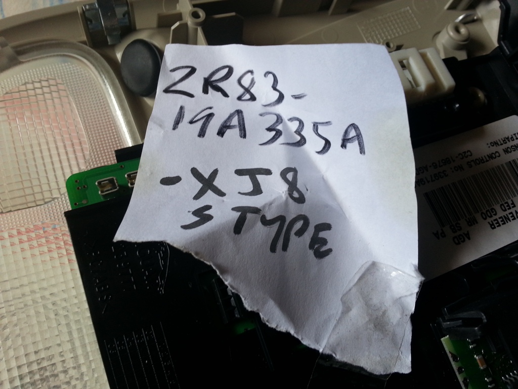

OK guys, I finally found a spare moment to dig out that roof console & have a look in the parts catalog...
First of all, the part numbers in the catalog for the roof consoles from X350 XJ and S-Type are different, I could not get any numbers to match up. The XJ numbers are all C2C... and the S-Type are XR8....
BUT
When I took the console I have out of the box, there is a handwritten note with the part number 2R83-19A335A, and it says XJ8 S-Type. It's handwritten so who knows how accurate that info is...
Put that number into google, and it gets a hit without the A on the end as an S-Type part. So maybe there are in fact compatible.
Trim colour is AGD which is Oatmeal. When I looked at it under natural light it's definitely more brown than beige...the veneer wasn't available as an option on the S-Type, it's the Burr Walnut from the XJ.
I've vinyl-wrapped all the veneer in my XJR so I was going to wrap this one to match the others, but the colour of the plastic is all wrong....
This console has garage door 433.92MHz, sunblind, sunroof, front parking switches. It does not have the intrusion sensors for the alarm system.
BUT

Just to bring this to a close.
Turns out that the console I had was a North American specification, the garage door module was for US frequencies.
Also, the X350 XJ and S-Type roof consoles are a direct swap.

S Type Overhead Console with GREEN LABEL UK/Europe Module (Jaguar Part No. 2R83-19A335
