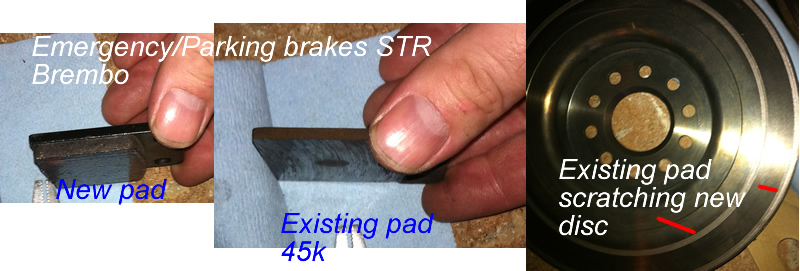

Thanx for all the posted helpful tips. Here's is what I just found changing them. I replaced my front rotors and pads. I have a 2005 STR with Brembo calipers. Front's are easy. The hard part is breaking loose the bolts, etc. Arkobono pads are great so far, no noise no dust.
Now this weekend I palnned my rear. My car has 45k, the rear discs looked bad and machined with scratches. I knew my pads were low. The rear Brembo are almost exact for replacement as the front, but smaller pads. The issue is that I assumed my parking/emergancy brakes were fine so after I changed the rotor I put the parking brake caliper but on. Mistake. CHECK YOUR PARKING BRAKES. The dealer didn't say a thing while in for a oil change and warranty work. They were GONE! I've added pictures. I lost a new rotor because of them. So now, today, I picked up the parking brembo pads from the dealer for $121 ouch!
Now that caliper is not the same, the tips here were VERY helpful! The tip about spinning the pistin to the right and being able to use needle nose pliers to turn it really helped. I now have new discs and brakes all around for 1/4 the dealer cost!

Ouch that looks painful, I'm about to do semi metallic pads on all six calipers since NAPA does sell the parking brake in semi metallics. I was hoping to find the EPB pads in ceramic but I can't find a manufacture that has them all matching in ceramic
Thanks for the tip about NAPA having the E pads.
Part #?
Bob S.
The STR rear parking brake pads are hard to find anywhere but the dealer. I did find them for about $80 on Rock Auto.
