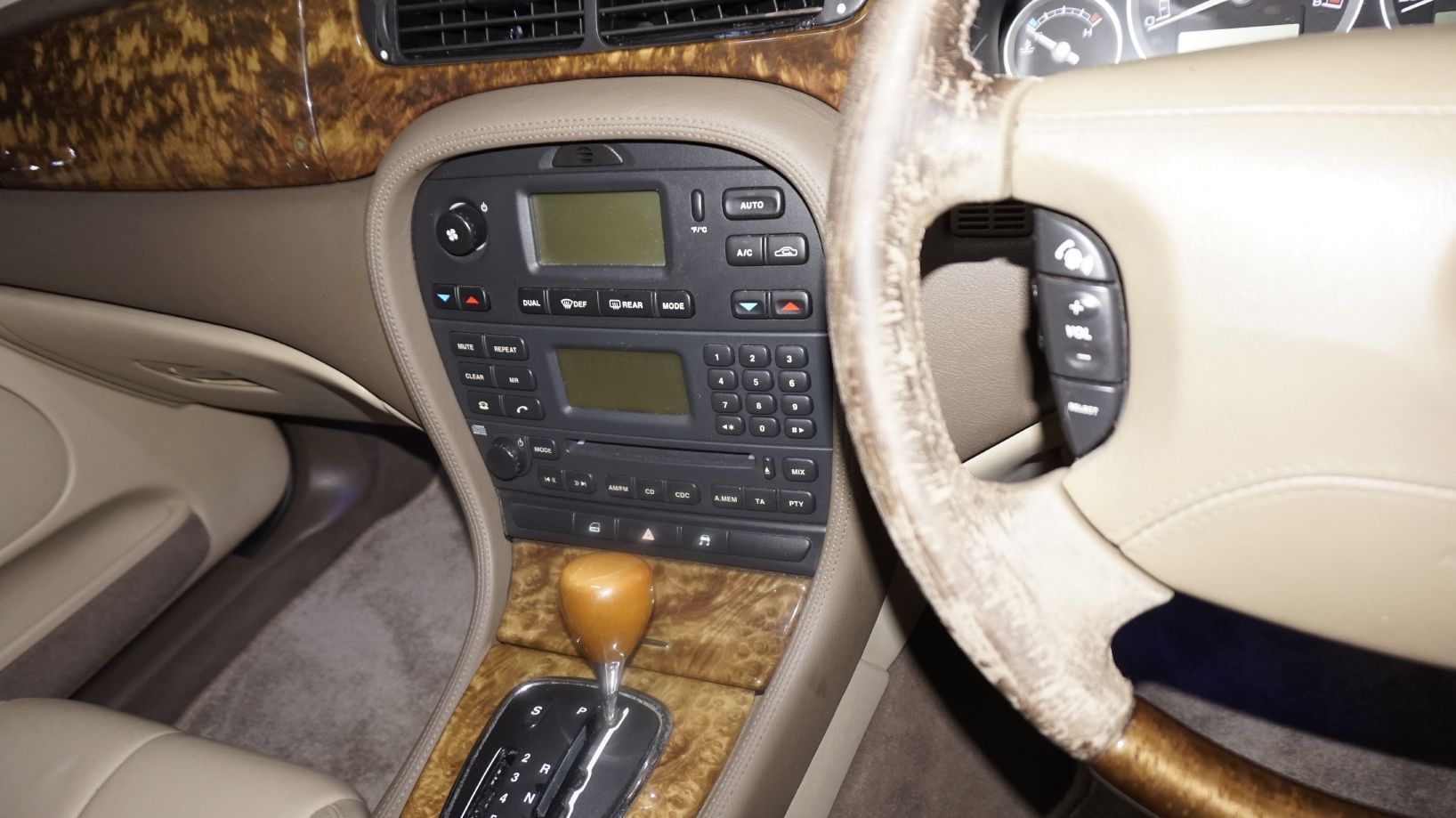

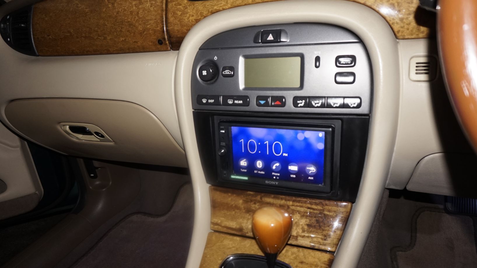

Anyway, below are the OE non-nav unit in the S-Type and the Sony radio in the X-Type (I just took those pictures and only then I realized that you have a Nav unit - but since I took those pics, I am sending them):
OE unit in S-Type
Unit modified with Sony radio in X-Type
