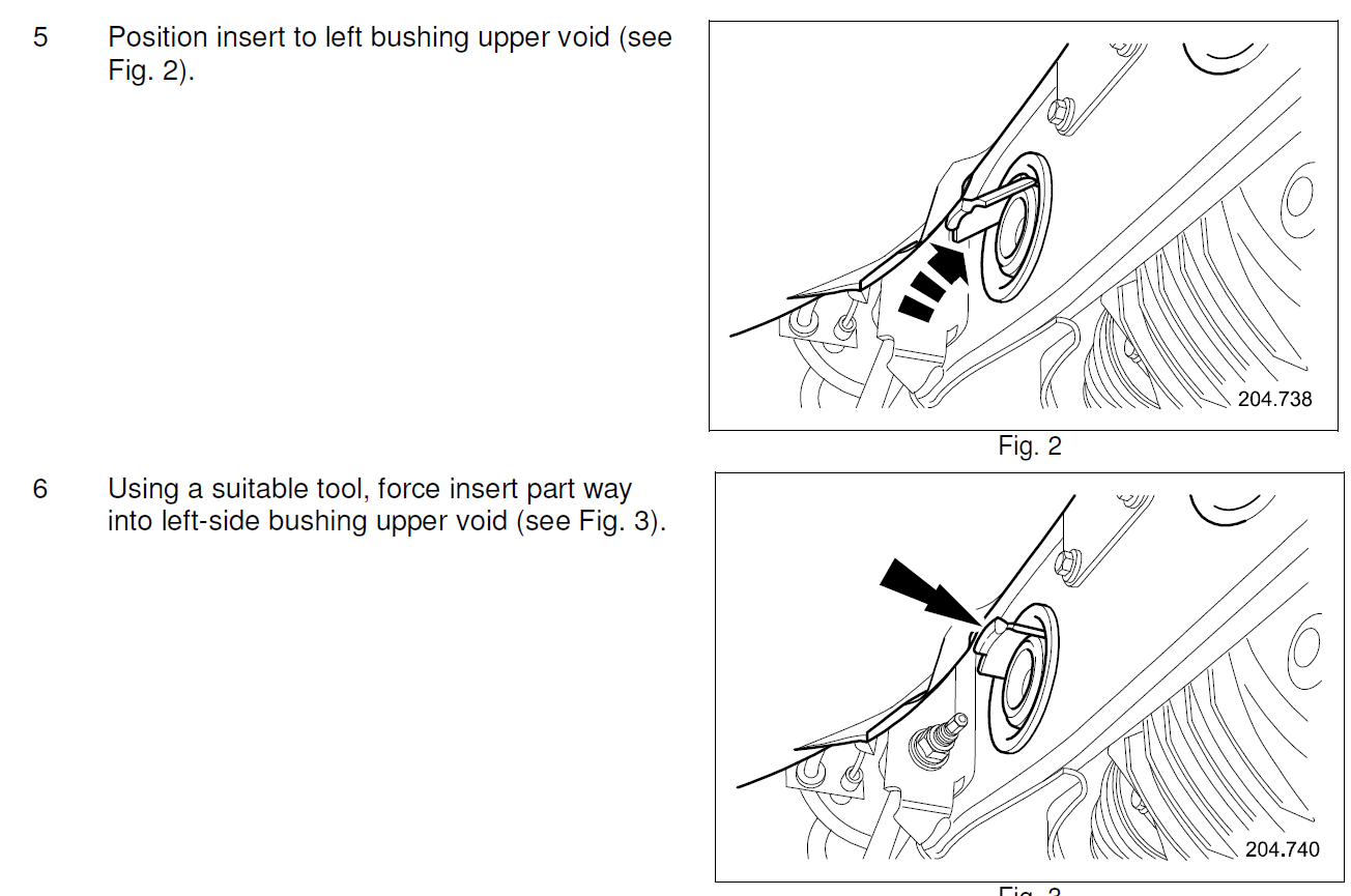

It looks like maybe Jaguar changed those bushings and removed the openings on all four sides and made the bushing solid?
I installed these inserts.
I have attached the TSB talking about them too.
File Type: pdf
