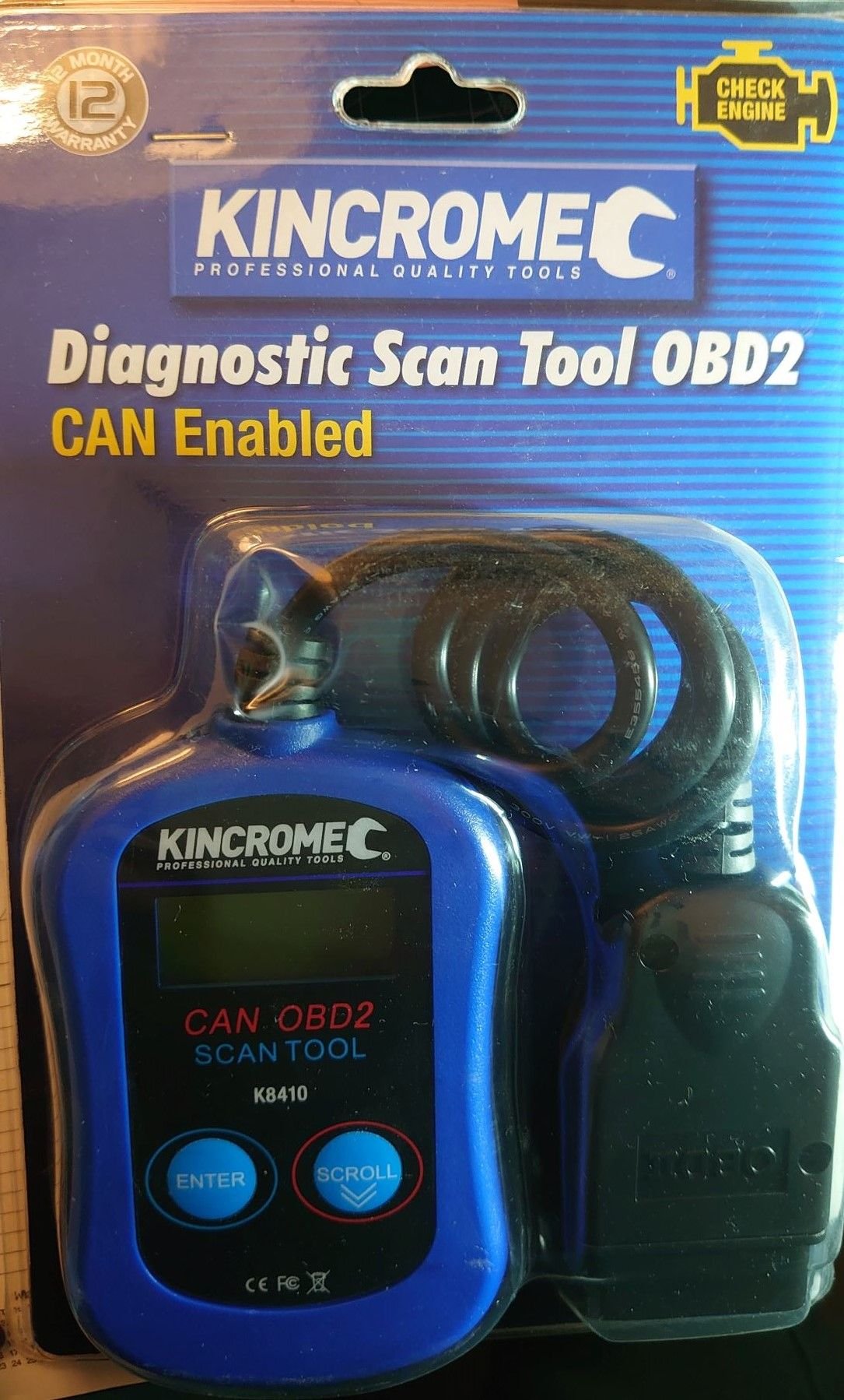

Found this at the local hardware. Not sure if the best product for my ageing X202? Should I spend some more and look for a better unit?
Any advice appreciated!

It's probably very basic, engine-only.
What do you actually want to do as there are existing posts which you could use to decide what to buy...
Although it's advertised as a "scan tool", that's a bit deceptive. It appears to be a very basic code reader and not a scanner at all. A true scanner is so much more useful for troubleshooting. It does all code reader functions, plus can show and record live data. Fuel trims, for example, are extremely helpful when chasing a vacuum leak. Live fuel pressure is the cat's meow when diagnosing a suspect fuel pump, and so on.
The extra capability of a true scanner is a bargain, as a basic scanner is not much more expensive than a simple code reader. I have a Bluedriver scanner myself. It has a small doohickey that I leave connected to the OBD port. It talks to my iPhone via a Bluetooth connection. I'm not especially impressed with this particular brand (clunky interface), but there are plenty of similar models out there at a very reasonable price. I think I paid about $60 maybe 3 years ago.
This model is generic OBD II only. It won't access ABS codes and stuff like that.
