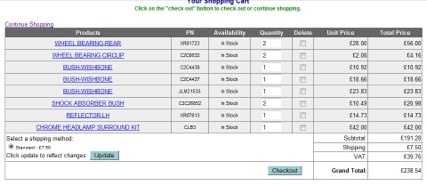

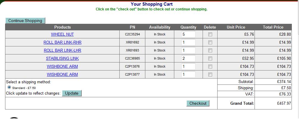

Britishparts.co.uk..I think have the best rates...check it now.. I have bought those parts from them coz I need to have some parts in my stock...but if u want an easy solution.. Buy Toyota corolla or same model car's small boots and after pressing the jouints of ur old stabilising links replace these boots with ur old one.. Mine links are ok but boots were damage and grease was out.. I just replaced mine link rods and stabilising link boots with a lot of grease.. And now after months it's working gorgeous...u won't believe Toyota's and Suzuki cars boots are same like jaguar's boots.. And u can but them less then 10$.. And now about bearing.. U can buy genuine bearing from that site in 30 pounds.. Coz I have two in my stocks too..see my attachments...
Attached Thumbnails Stabilising Link for Rear Suspension / Wheel Clicking-web.jpg   Stabilising Link for Rear Suspension / Wheel Clicking-img_0366.jpg
