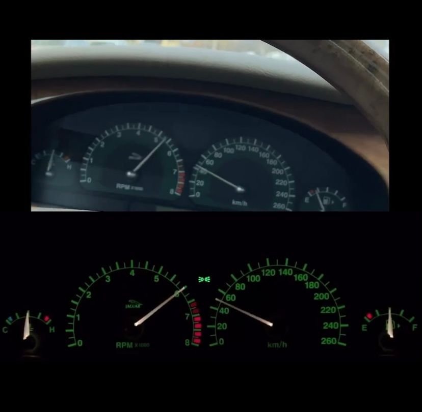

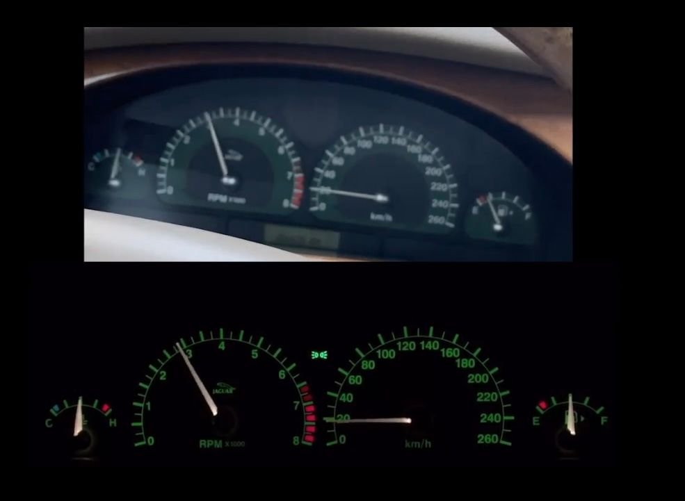

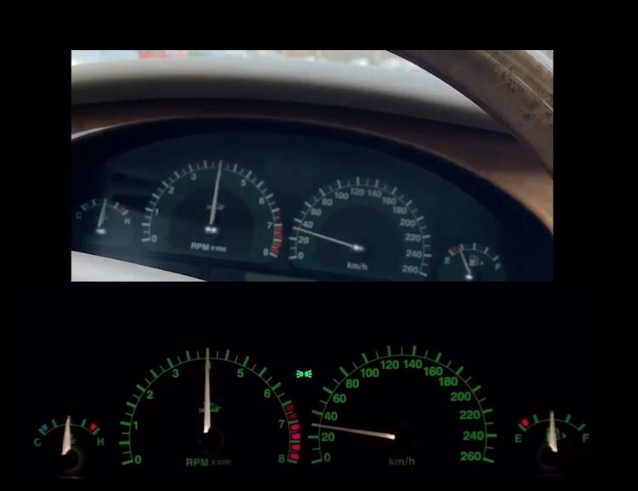

i filmed a 3.0 2003 stype doing a 0-100kmh run, and i took the first youtube video with the same run and car from a guy named GAS ZURICH (credits to him) and snapped them togethe for a comparison.
To be pointed out:
tires:
-His car has the stock R16 Spirith wheels (225mm wide tires).
-car i was in has R18 Mercury wheels (245 40 on the front and 265 35 on the back)
Gas:
-i dont know what gasoline he was burning, but since it's an austrian/german video i assume 98 or 100 european octane.
-the car i was driving had 95 european octane.
This car had its injectors cleaned, and fitted new injector filters. main gas filer is new.
air filter is new. New imt Orings. All carbon deposits were cleaned, new plugs and gasketf for the manifolds too. Maf is clean, throttle body is clean. You get it
Car has been taken good care of.
Conclusions and screenshots below:
(im trying to post the video as a reply to this post)
(videos are synced as so both cars are starting at the exact time)
The S type that im driving gets slower after 4000 rpm!
any ideas of what to check? Or why that is?
could better gasoline and the narrower tires do such a big difference in acceleration?
When the german Stype gets to 100kmh, im doing 83kmh.
PS. I know acceleration runs are sensitive to parameters, but there must be an answer for this phenomenon of being slower after 4000rpm

He has the earlier model. Yours is later. They have different engine management, induction system and power output.
This assumption is based on the two sets of instruments being different. Yours has the later style.
Reply 0
Mar 17, 2022 | 09:12 AM
Quote: He has the earlier model. Yours is later. They have different engine management, induction system and power output.
not true. cars are identical years and execuitive models
Reply 0
Mar 17, 2022 | 03:18 PM
Quote: not true. cars are identical years and execuitive models
Interesting. I wonder why the instruments are different.
The Germans like a bit of speed. Do you think his could have been remapped?
Reply 0
Mar 17, 2022 | 03:59 PM
they are the same, but the bottom video is during the night. non facelift s types have like an older font to the text and different needles.
who knows about the remap... but his car is stock and what remapping could he have done to a stock setup, hmmm. tho' im sure he's got the best gasoline.
