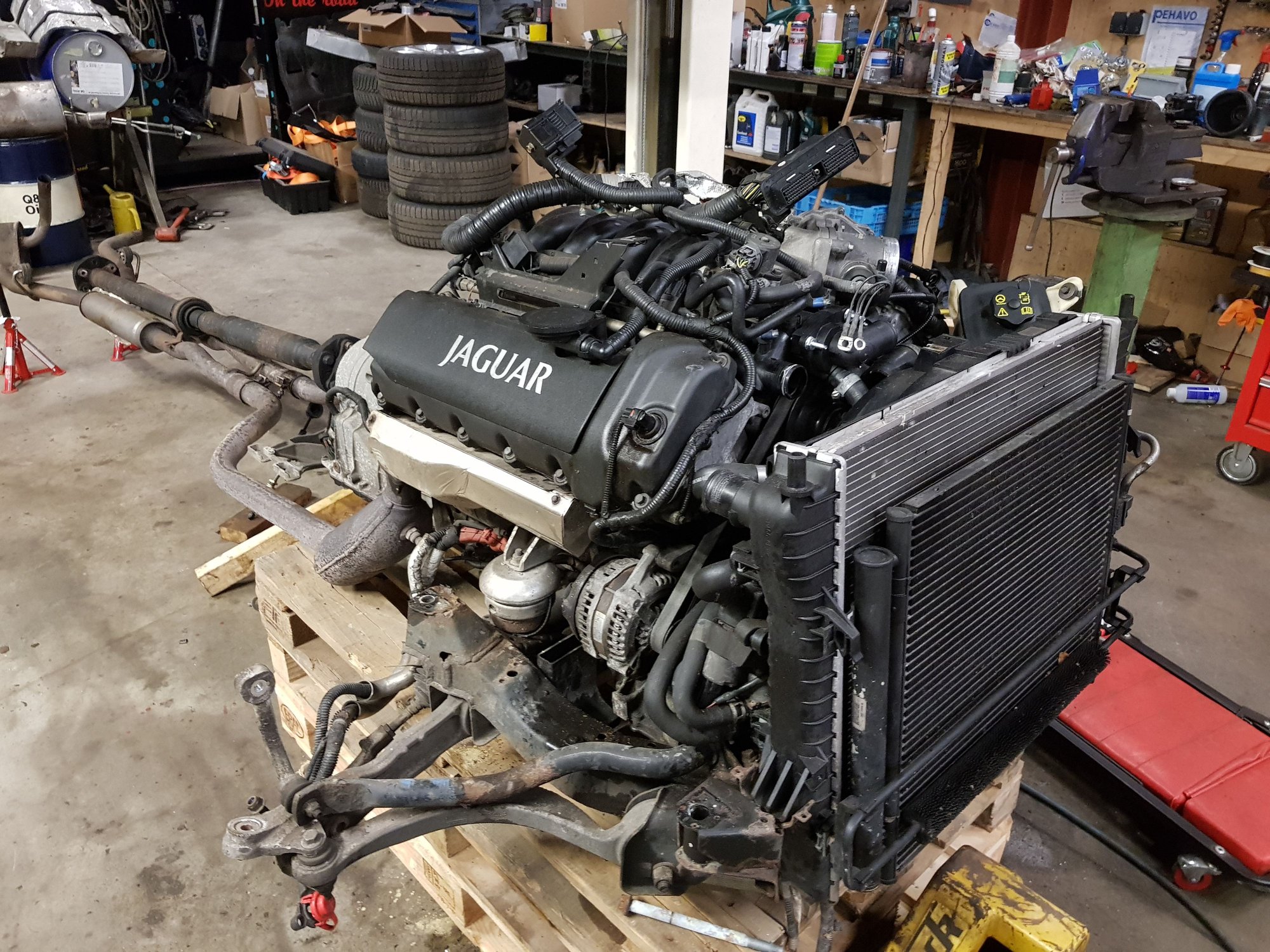

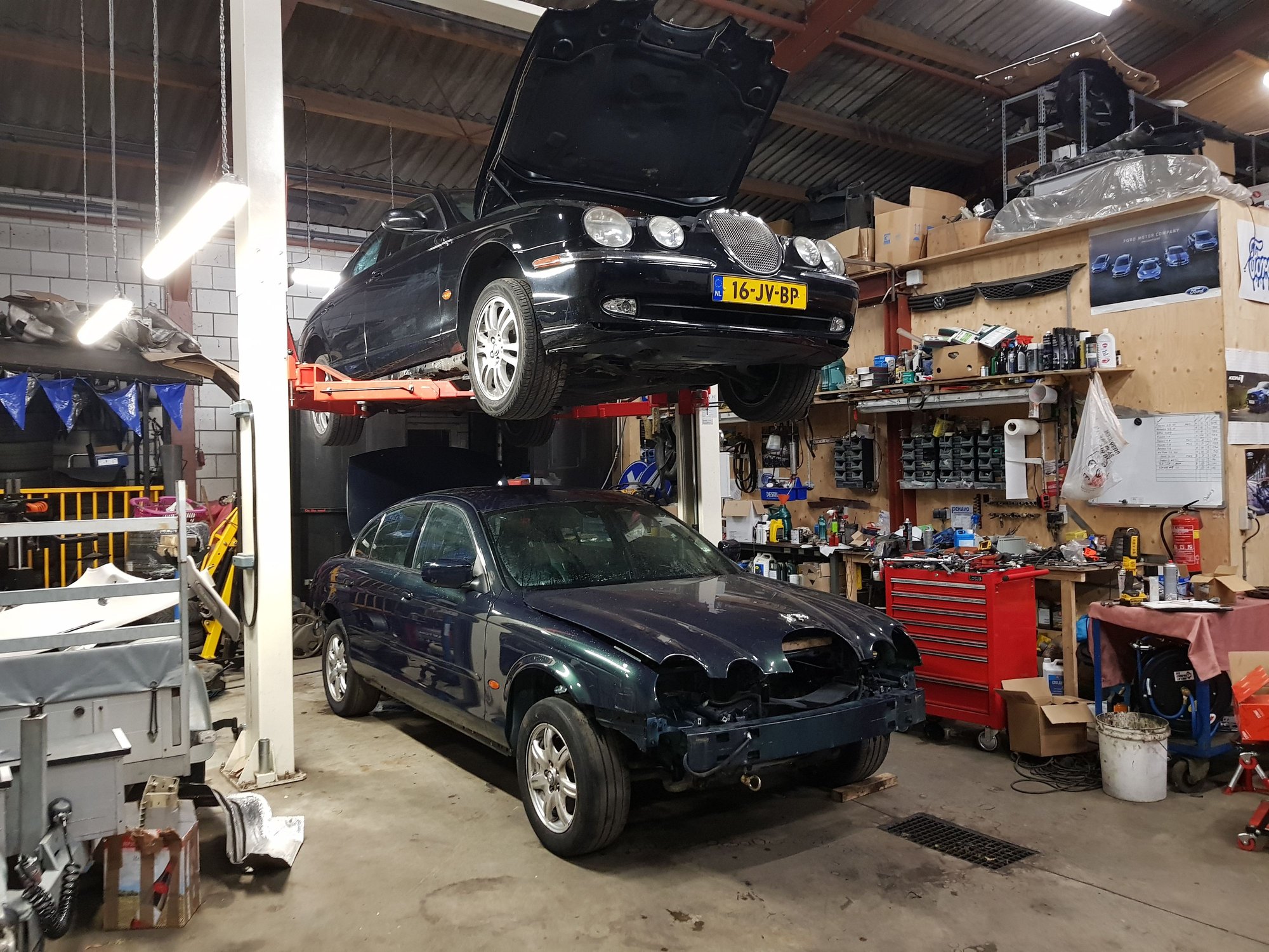

no, it wil have the 4.2 v8 and 6 speed auto box😋
and al the faceliftgoodies.
The black one is the 4.2 donor(car is totaly rusted and almost stripped)
bottum one(green one) is the project that was an 3.0 v6 and it wil have this v8 at the end
