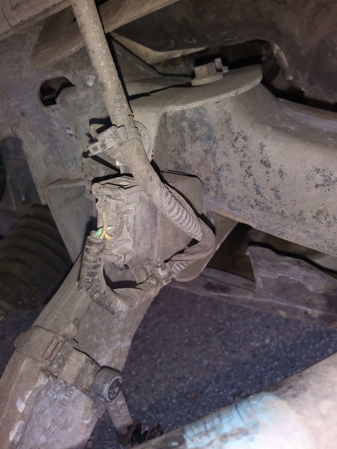

Anybody know what this is? Mine is broken.
i want to replace thing in the passenger front wheel well. What the hell is it?

Im gonna say ride height for adaptive suspension

Yes, it's the ride height sensor also used to level the Xenon headlights.
You can buy used but better off getting new since they start to fail at this age anyway. SNG Barrat has them for $98 without the bracket.
