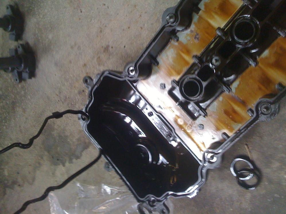

My gaskets are leaking around the sparkplugs and making a missfire,But i think i got it taken care of...

keep trying on the pics Dking... so the gaskets were replaced, coils and plugs removed and cleaned/dried, then fired up and runs good now? A coil (or coil) may have gone bad from the constant inundation from oil and may need replaced. Thankfully, codes can tell which coil exactly.

yes i had 1 coil go out,when i got it to miss under a load,and my trans shifts great now too.it took 21/2 hours to do both sides,the o-ring type gaskets broke and cracked when removing them,i had to use a pick....and the engine is so KLEEN!!!
