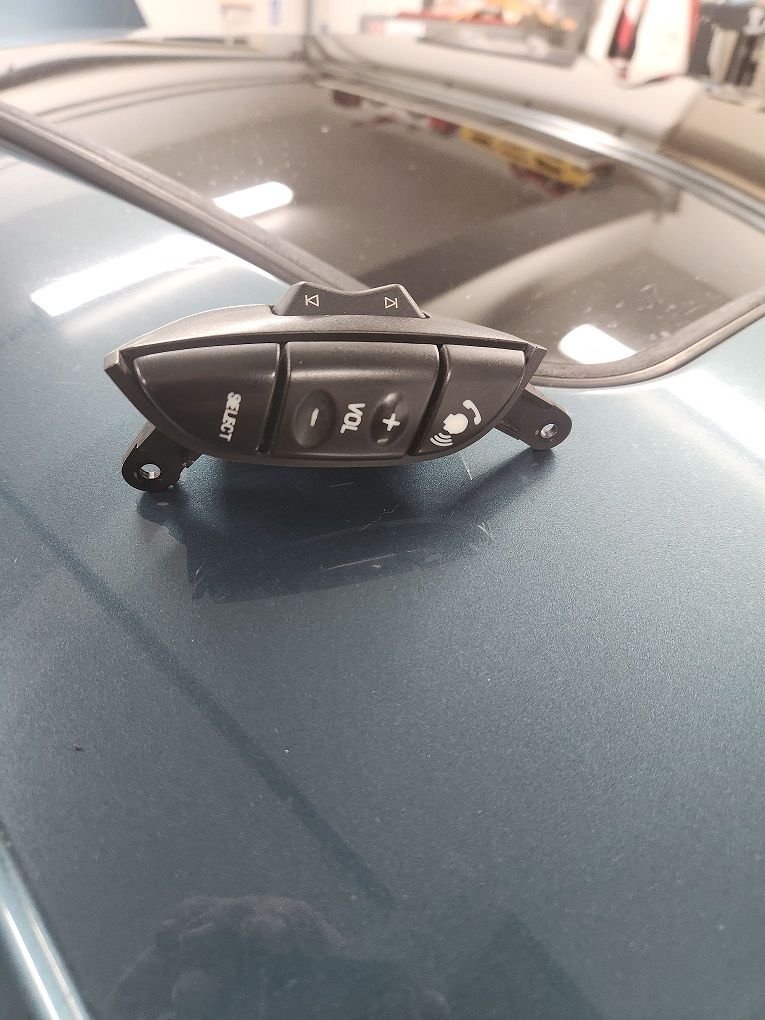

I will start - last week my voice control system started randomly coming on, trying to dial the phone and other random functions, Nonstop. The first time it did this it scared the crap out of me as I didn't realize it had a a voice module. Its 3:00 am and i am in the back seat trying to dry the car out and all of the sudden this voice comes on and tells me (at max volume) its trying to dial home. I straight up hit the roof with my head . Anyway it turns out it was a faulty switch in the steering wheel. I recieved one from Ebay today andI am putting it in now
