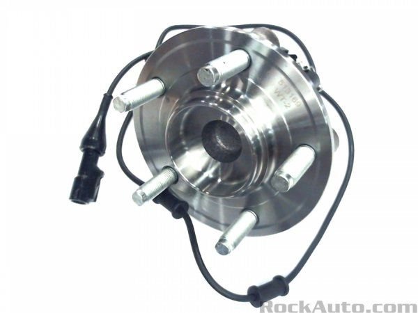

I just replaced one of my front wheel bearing and hub assemblies for this exact same reason. Les Scwab wanted about $500 to do just the one side and I ordered mine from Rock Auto for $70 and did the work myself. Took me about an hour and it was easy
They are self contained (hub and bearing assembly) and include the speed sensor

Jack the car up, be sure to either use jack stands or make sure you dont put yourself in a position to get pinned under the wheel or body . Grab the wheel with both hands at 12:00 and 6:00 while the tire is still on the car and try to rock the wheel. if there is any play whatsover it is most like the wheel bearing assembly
