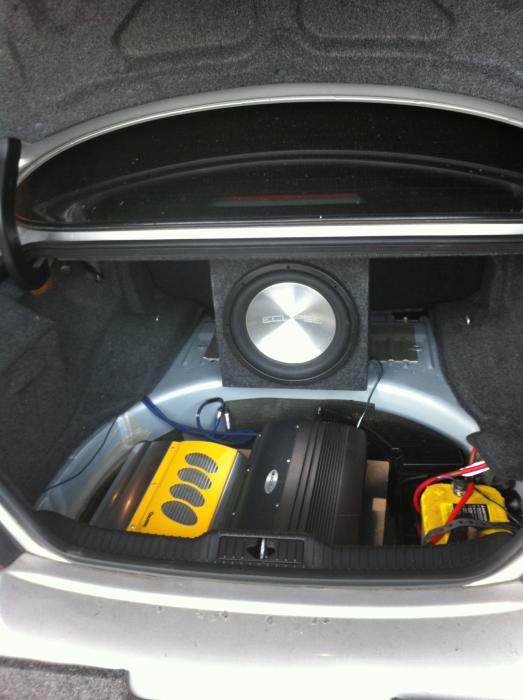

I'm a firm believer in optima batteries.
I put Optimas in everything generally I prefer the yellow top because it can take more of a beating, but then again my car has an "upgraded" stereo.
it's not a 100% direct fit, you need to make your own tie down, I used perforated exhaust hanger.
Take care,
George
George, that's not a cable sandwiched between your Optima and the strap-hanger is it? Surely the pic deceives me!
-Zane
-Zane
Not sandwiched.
Follow the strap hanger to the right, see the dark wedge? That's the tenson point of the hanger, that and the corner of the battery. There's at least 3/4" of clearance between the cable and the hanger. But yes, the cable goes under the hanger. (zipping up flame suit now).
Take care,
George
Old Feb 22, 2011 | 09:18 AM
aholbro1's Avatar
Posts: 4,618
Likes: 1,656
From: Decatur, TX
It's kewl
I was prepared to compliment u for the apparent slack in your battery strap, given u routed a cable under it......but it all makes sensewith the wedge. Didn't see that.
