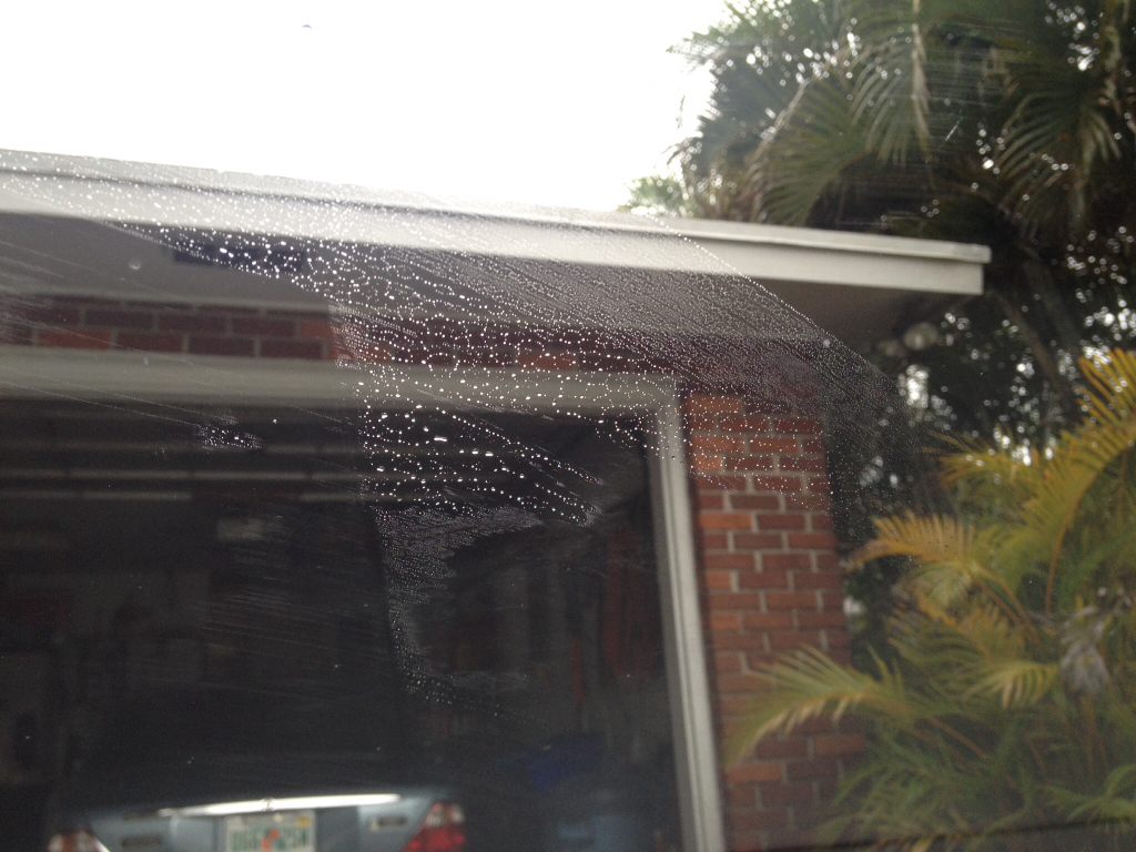

The blades are 18" (passenger's side) and 24" -- the passenger's side seemed to be a bit longer than 18", but not 19".
I'll try to post the video I did that shows the malfunction.
Here's a still photo of the area that doesn't get wiped clean. This photo was taken after the rain stopped and the wipers had already wiped the windshield clean! The down stroke leaves this mess!

Mike-
I see the problem very clearly in the video. No such issue on mine, but let me ask- do you take your car through an auto car wash? If so, do they add a 'wax' of some type.
My father had the identical issue with his car (non-Jag) and it seems the build up of wax on the glass just smears everything, even though the wiper blades were new. We used a concentrated glass cleaner and a Scotchbrite pad and problem gone.

From: BC Canada
From the video, problem seems to be caused by the wiper blade on the left. It's almost as though the wiper arm/blade are not contacting the windscreen at all in that position.
I had almost exactly the same problem when I bought my 2005 STR. The previous owner told me that he had fitted brand new Rain-X wiper arms and blades. While that appeared to be true, it was obvious that for one of the blades there was no contact with a portion of the windscreen.
Took the car to the Jag dealer, and they said "wrong arms, non-Jag". Fitted the right arms/ blades and everything was perfect.

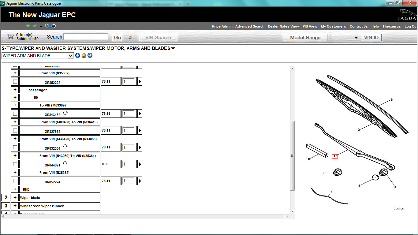

Old Mar 30, 2014 | 06:52 AM
Posts: 121,178
Likes: 6,658
Originally Posted by OldMike
Any idea what the part number is and where I can find them?
Here you go:
Attached Thumbnails Windshield Wipers-untitled.png   Windshield Wipers-untitled2.png
Old Mar 30, 2014 | 11:15 AM
Robinb's Avatar
Posts: 880
Likes: 182
From: BC Canada
Before you go splurging big bucks on wiper arms, I should tell you I think I've got the terminology wrong. It wasn't the wiper arms, it was the wiper blades. I think it was about $38 for the pair.
