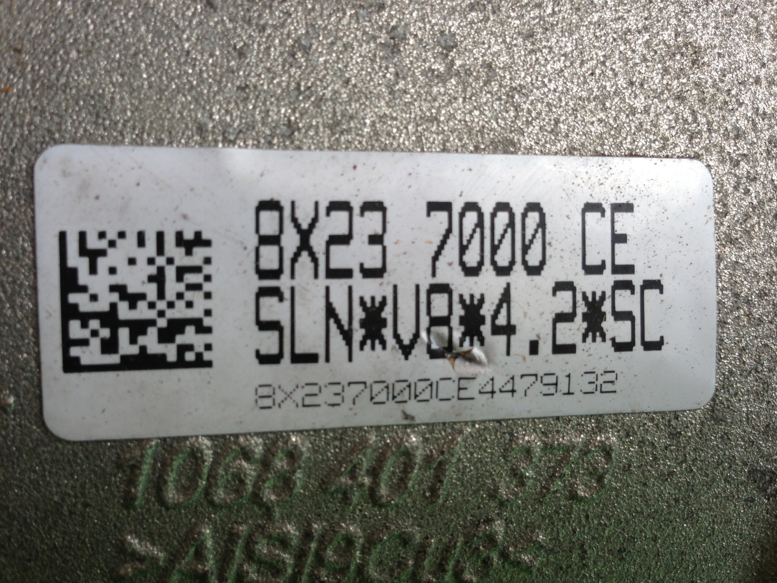

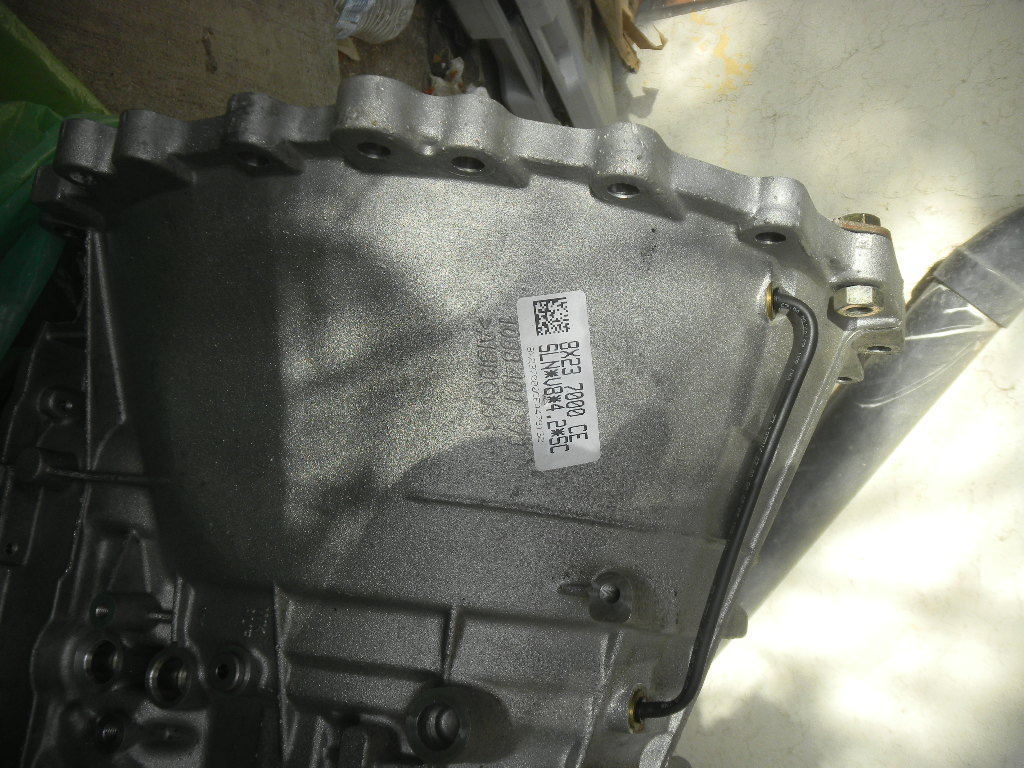

Default Pics
Heres a few pics
Attached Thumbnails is this zf6HP26 worth it?-tranny.jpg   is this zf6HP26 worth it?-tran2.jpg

hmm, 8X23- etc looks like an XF part #
If it's a ZF for an XF I don't know what's different. May only be the software, and that can be reflashed. If that's all it is...
I think (but am not certain) that the ZF 6HP26 boxes for the various S-Types are only different in the software that is preloaded into the TCM - neglecting fixes and tweaks done as ZF made more and more boxes.

Yes the basic transmission is a 6HP26 but it is different between the different engines. The STR has the highest rated version and has more clutches inside to handle the higher torque rating of the 4.2L SC Engine. I am sure there are more difference than that too.
Example; I would not use a ZF from a 4.2L NA behind the SC version. It would bolt up and work but I don't think it would last unless you were real gentle with it.
