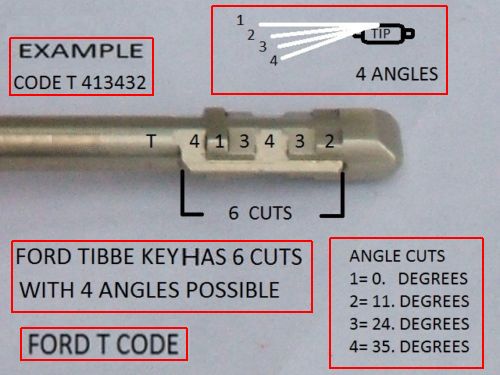

Just searched your "handle" and see you have an XJ40. I'm not sure if that uses a Tibbe 6 or 8 key? My XJ350 uses Tibbe 6 but the cutting and concept are the same just different blanks.

Mine is definitely a Tibbe 8. I'm glad to see another Jag enthusiast in my neck of the woods.
