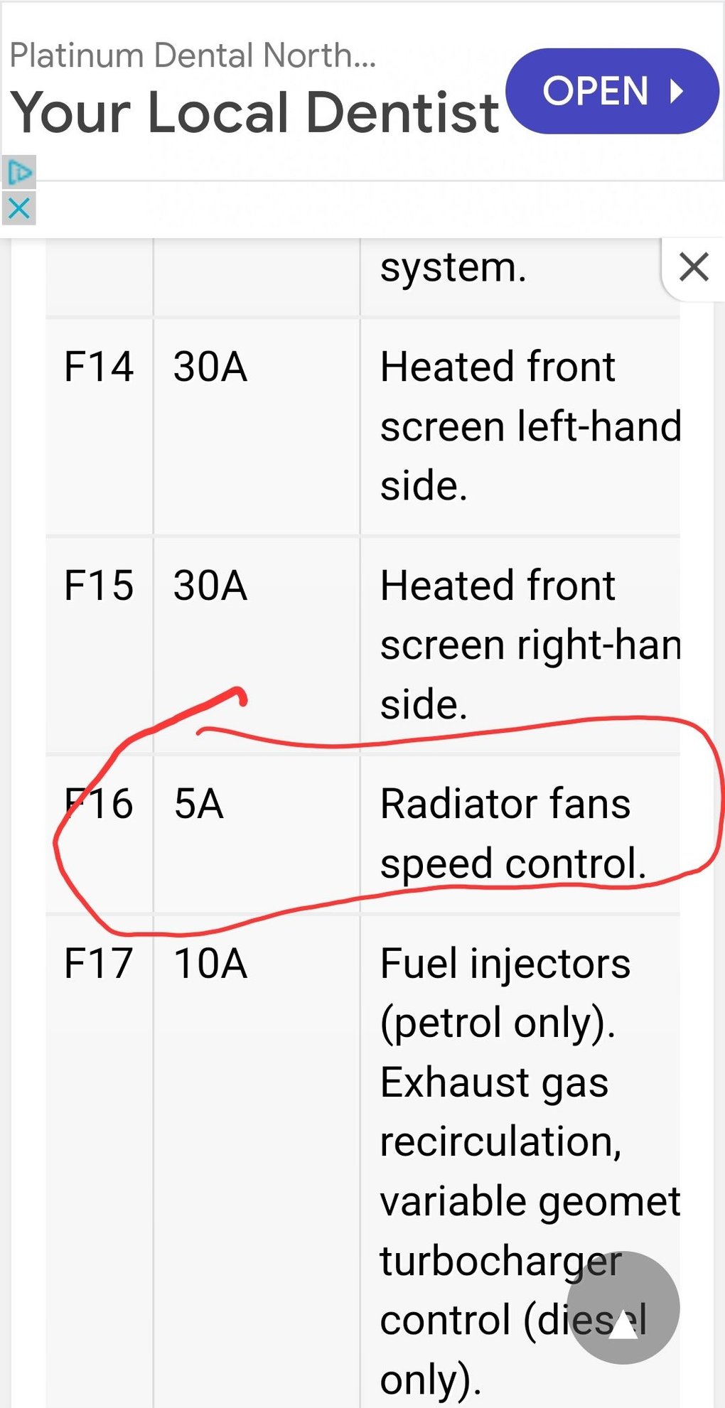

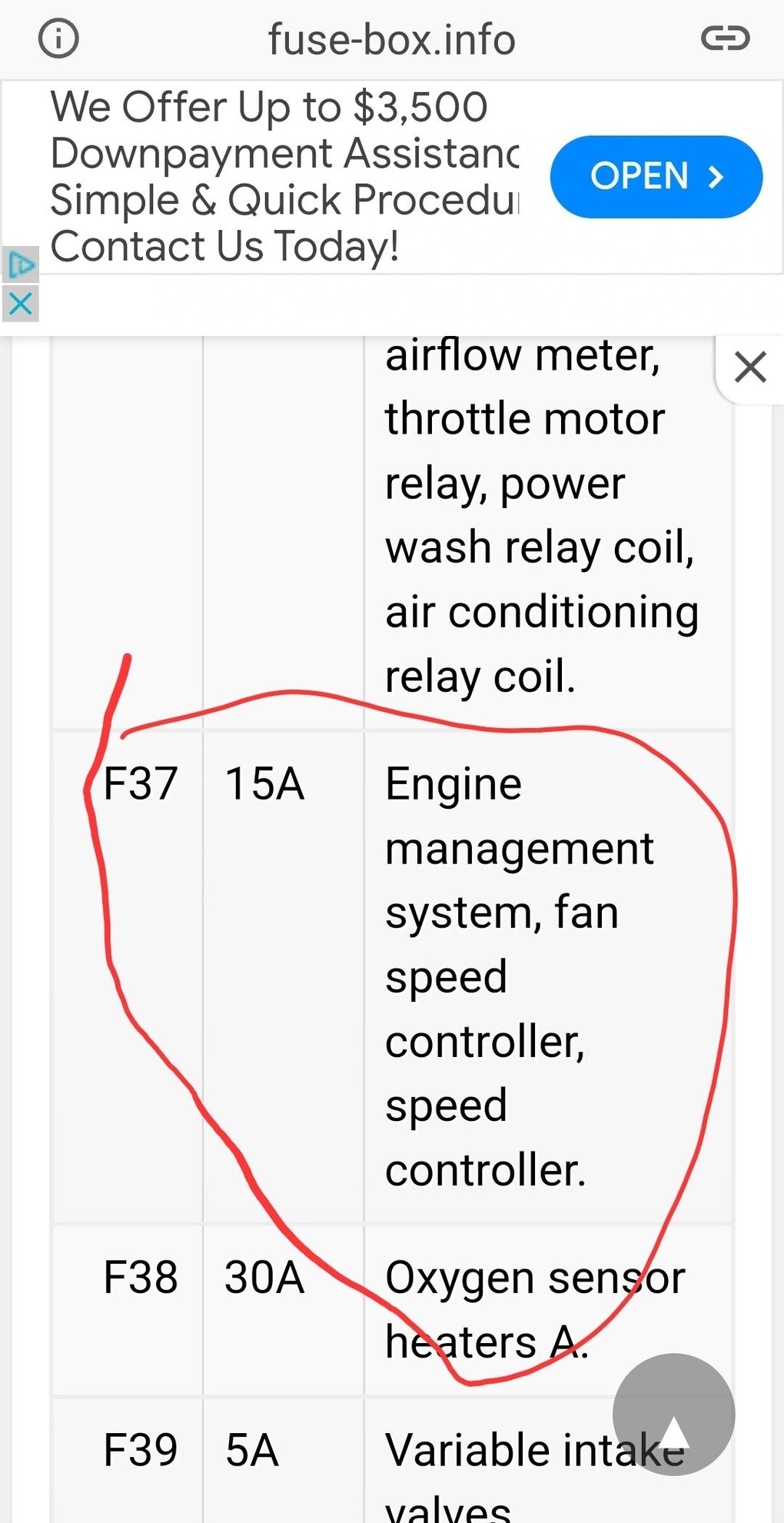

what fuse i can check ? Where is that fuse location? Couldnt find any other fuse than the F16 -radiator fans speed control.

Because you have a 2004, it depends on manufacturing date (2004 versus 2004.25 = before April 2004 and after April 2004). The fuse is in the engine compartment fuse box.
Pre April (2004) =
After April 2004 (2004.25) =
