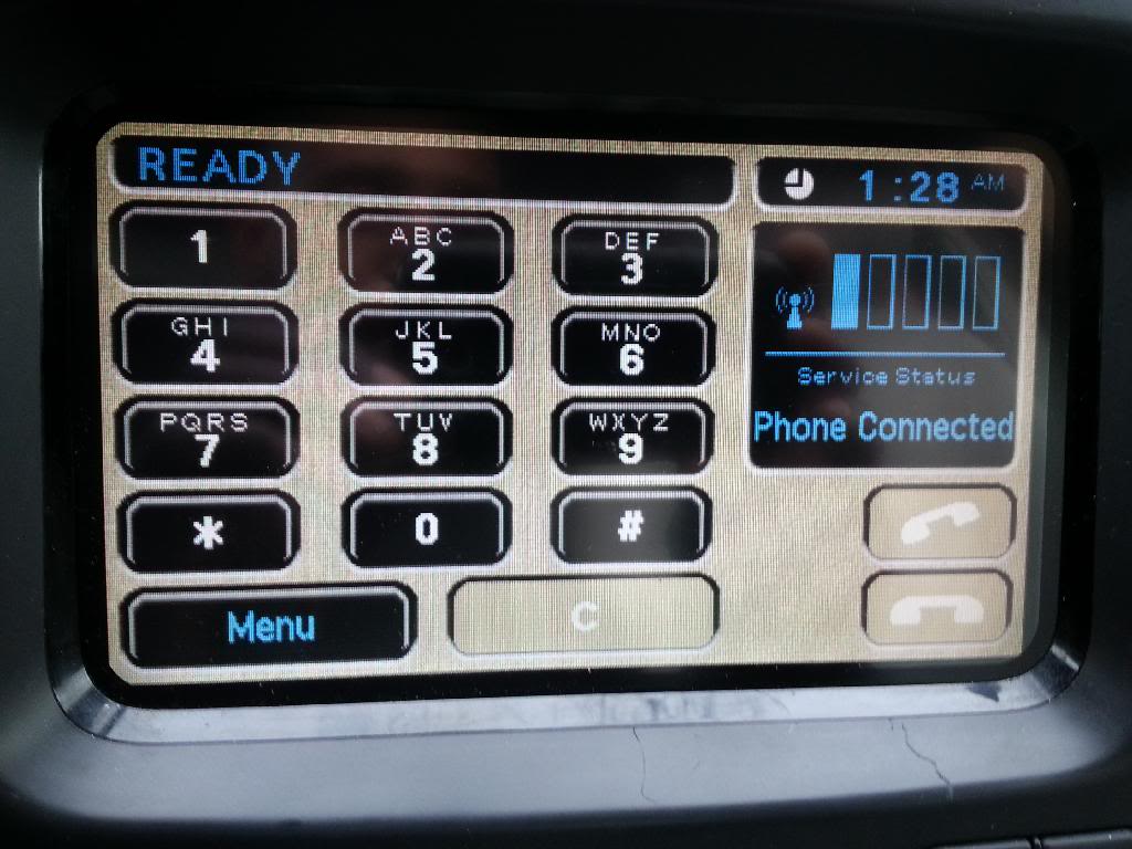

it can be done i retrofitted mine it works perfect
https://www.jaguarforums.com/forum/x...s-info-102632/
you need these modules
you are going to need a btum
