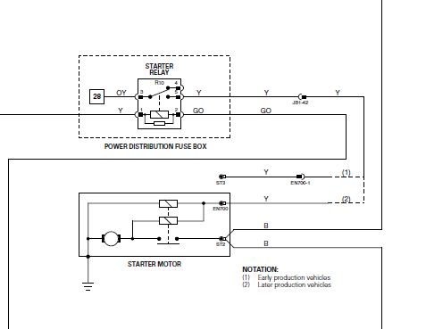

It may be that your starter has a bad spot on the armature. If you look at the schematic below you will see that there are two windings in the solenoid. The pull in winding uses the armature of the starter for a ground which it loses when the plate connects the battery to the armature. Then the hold in winding keeps the starter engaged. The hold in winding doesn't have enough pull to to engage the starter.
