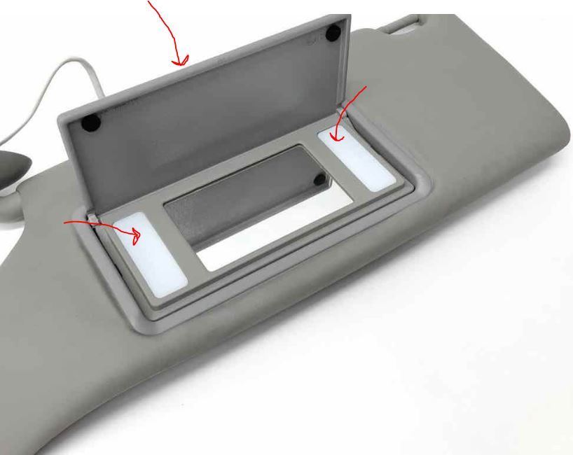

Hello all,
I replaced the defective sun visor front passenger lights on my 2002 x type but the lights still won't come on.
Questions:
1. Does the sun visor have a fuse?
2. The little door is missing so is that door the switch to turn them on and off?
Any help would be greatly appreciated
RM.

F99 and yes

The lid hinge operates the switch.
Jaguar issued a TSB a few decades ago for info on the bulbs.
