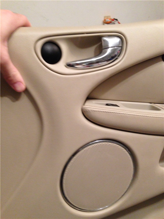

Also found that someone had tore out the factory speakers in the doors and installed some 6-1/2" Dual DS-Series 2-ways (walmart crap speakers).
So when to a local audio shop and bought some 6-1/2" Polk Audio DXi-6500 (components), right now running them off the factory head unit. Managed to have time to install the front and back passenger side. Next weekend plan on getting the other two doors done. Here are some pics as well.
Attached Thumbnails ABS, Engine light, random probs...-front-passenger-door-tweeter-1.png   ABS, Engine light, random probs...-front-passenger-door-tweeter-2.png   ABS, Engine light, random probs...-front-passenger-door-1.jpg   ABS, Engine light, random probs...-front-passenger-door-2.jpg   ABS, Engine light, random probs...-rear-passenger-door-1.jpg
