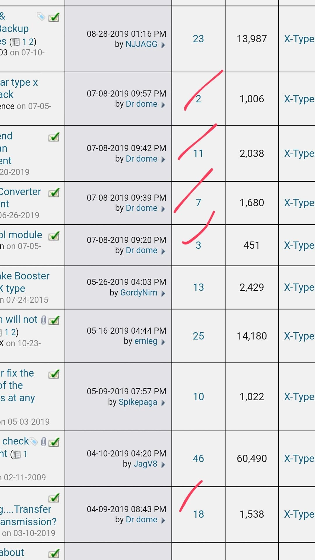

Contact member Dr. Dome

How do I contact Dr. Dome ? Slow as **** internet here and hard to swim thru the forums. Anything helps. Thanks, Mike in NW MN

SEARCH by member name, click his name, send a PM

Can't find Dr. Dome no matter what search I try. Can you help, or is there a phone #, or website, or a TARDIS link ???? MIKe
