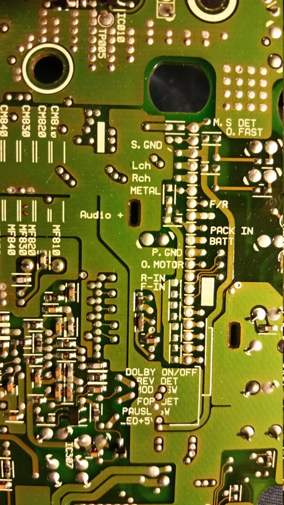

I have one of these splattered all over my bench right now.
I am actually mounting header pins in the holes, and I'll use a connector to attach them rather than soldering.
When you insert a disk, a mechanical switch actually turns on the CD motor and audio; I plan to steal an unused switch (or add another) to send the signal to turn on the audio inputs without needing to spin up the motor and laser.
Pinout is attached.

Thanks!! I can't wait to have aux cables in the car. From there I will be able to easily do bluetooth and more .
