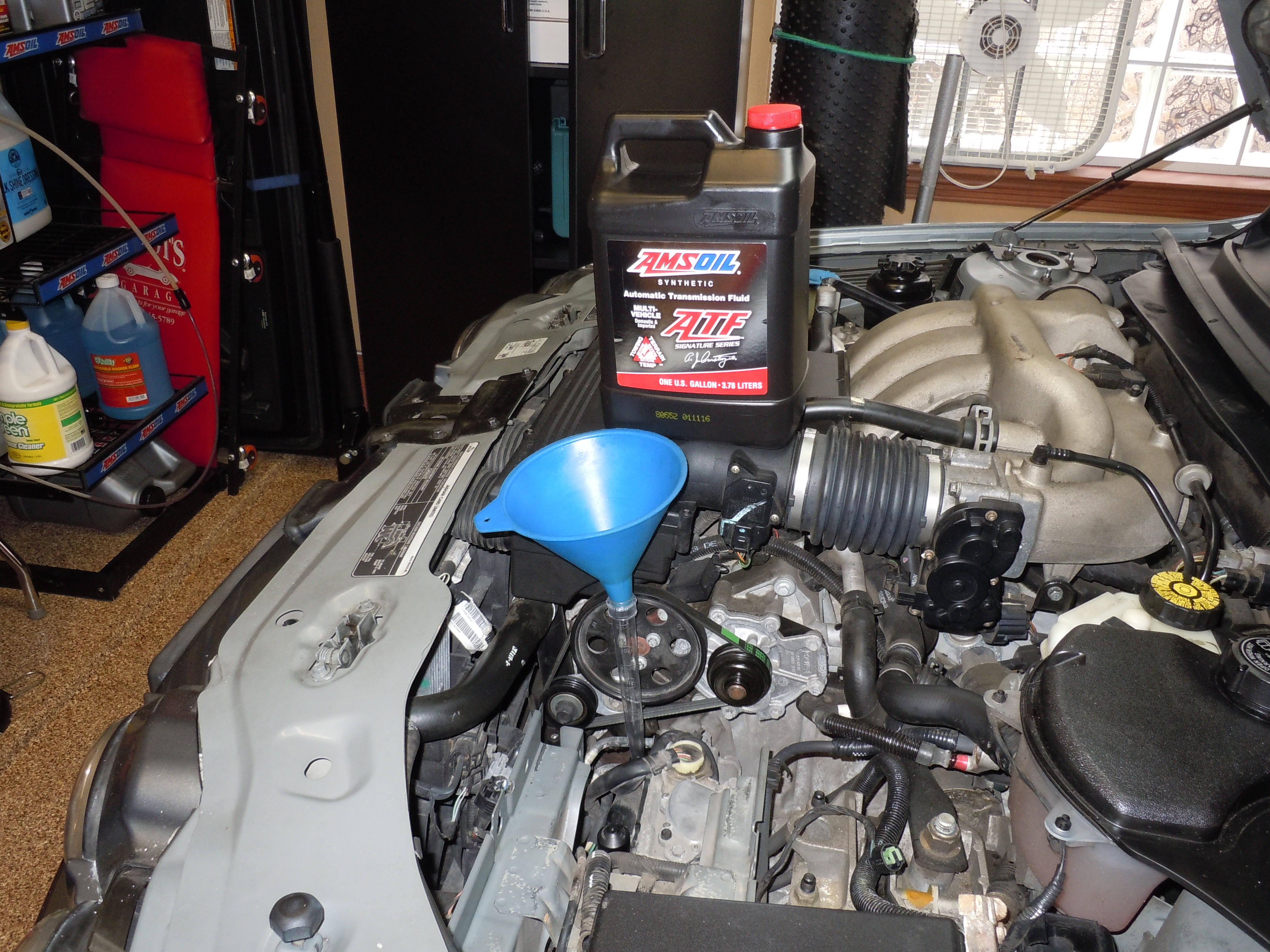

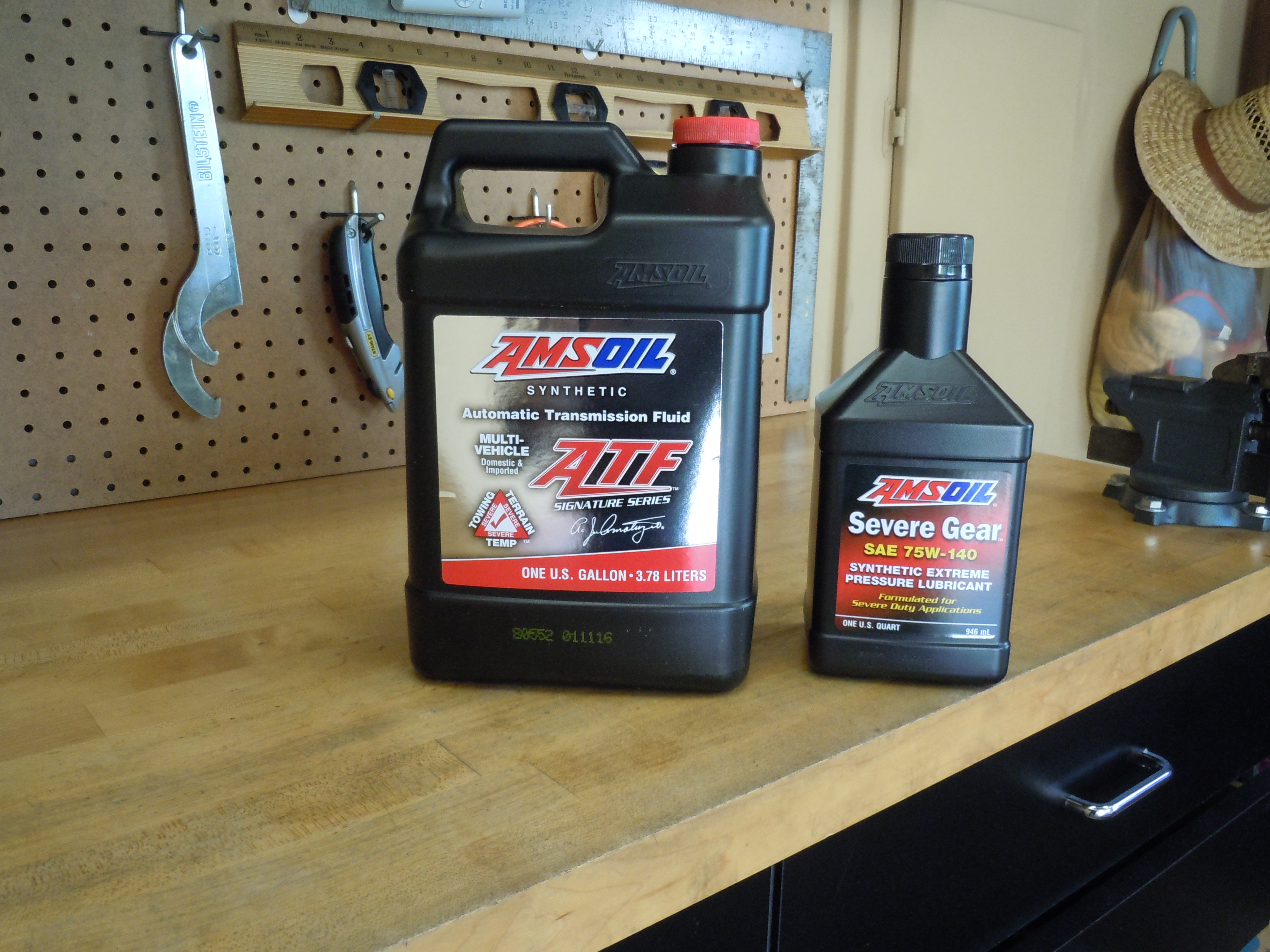

Are you sure you don't have a transmission problem rather than transfer case? How many miles on your car? Jaguar says transmission, transfer case and differential fluids are "Lifetime Fill." I bought my '04 two months ago with 105k miles; servicing all three has given me very noticeable improvement of all the work I've done on it so far.
Attached Thumbnails Best Place for Parts?-atf-fill.jpg   Best Place for Parts?-atf-diff.jpg

Grinding noise when putting shift lever in park is from the transmission, not the transfer case.
When You Put the Car in Park - How Automatic Transmissions Work | HowStuffWorks
It may be that your transmission is toasted, but I'd try doing a fluid service first before making a decision. It's not that hard, but I found removing the battery box gave me the best access to the small fill plug at top of transmission. It'll cost you 4 quarts of of ATF, and you'll most likely be really shocked at how horrible the drained fluid looks. If you service the fluid and the transmission still isn't working properly then you're prolly at decision of whether to replace the transmission or junk the car. Rock Auto offers the transmission, but it's not cheap. If you replace the tranny then transfer case has to come out too so you can deal with that separately.
