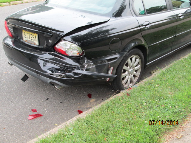

All, my 2004.5 X-Type Sport was rear ended by some low life who hit it & ran as it was parked in front of our home. The body shop needed 4 weeks to repair it. I have a question about what happens when the remote trunk button is depressed. I used to think the trunk/boot popped open. Mine doesn't move. It clicks & unlocks, but I have to lift the trunk/boot lid to open it. I see two plastic spring assemblies that are next to either hydraulic piston (I can't think of the proper name), but they don't seem to do anything. My memory is fried & my rental cars had trunk lids that pop open, but what about my cat?
My question to anyone with an X-type is, does the lid pop open or do you have to lift it? I feel a little resistance. It's not surprising considering the trunk lid was pushed into the car. Do the plastic things with springs serve any purpose?

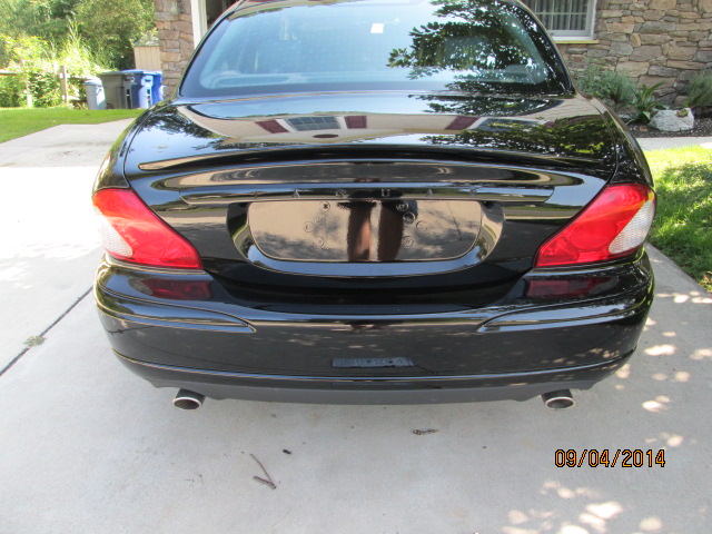

Hey everyone,
The body shop replaced the poppers & the struts. The trunk lid now moves up about a 1/4" and it is easily raised once the trunk is unlocked. I think they also had to do some body shop magic as the trunk lid was repainted. It all looks good.
One thing they had to do was remove the chrome 3.0 badges on the rear of the car & haven't replaced them as new ones haven't arrived. Being I drive an X-Type Sport model, I don't care for any chrome. The body shop said they could leave the chrome 3.0 off or if I want to 'pimp my ride', they have a pin striper guy who could fill in the rear Jaguar letters with white pin striping. I figured I'd ask the forum & get other's opinions.

"Badges? We don't need no stinkin badges..."
Thanks! That's exactly what the body shop wants to do, except they'll do white pin striping in the JAGUAR letters. I don't care for chrome which was the reason I went with a sport model.
Here's my car after the repairs. It looks & works like it should.

Nice repair job Backhertz , the bodyshop you used need a big " Congrats ". Looks like they take pride in their work . I'm a carspray painter from way back ..only cellulose in those days..
