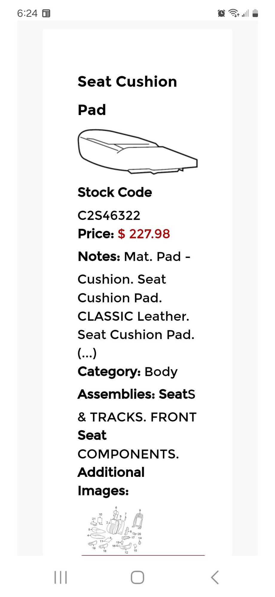

c2s38056
c2s46322 (c2s34018, c2s37335, c2s38900)

Seat cushion pad =
For heater, try Rimmer Bros = U.S. Phone # = (855) 746-2767
I think this is the correct part # for the bottom seat = https://partsinn.lt/?oem=LHF2700AA
