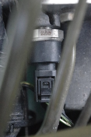

ABS light and code C1288.
Being a cheap ### I'm trying to fix my ABS light without spending $300 for a brake pressure transducer. Part # C2S6180.
Is it possible to take the offending part out, give it a good clean, and put it back in? I've been ignoring the light for over a year now. But I think it's time I tackle the problem.
Or, does anyone have one they can sell me?
Heres the troublesome part..
Attached Thumbnails c1288 code fix? (ABS)-file_zpsbfbb6cc3.jpg   c1288 code fix? (ABS)-file_zps9328deae.jpg

flyrr, see if the Lincoln LS 3.0L or the Volvo S40 part is the same piece. May be able to get it for much cheaper since it is not a Jaguar part. Might even cross over to something that would work in the Ford line-up (Fusion, Focus, etc). Might be worth a trip to the Ford dealership, give them the number you posted above and see what they say.
NOt that this helps too much, but, Jaguarparts.com has the switch for $237 plus S&H. Saves you about $50 over the list price. Probably something that you might be able to pick up at the junkyard for around $100 or less.
