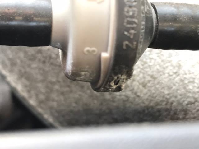

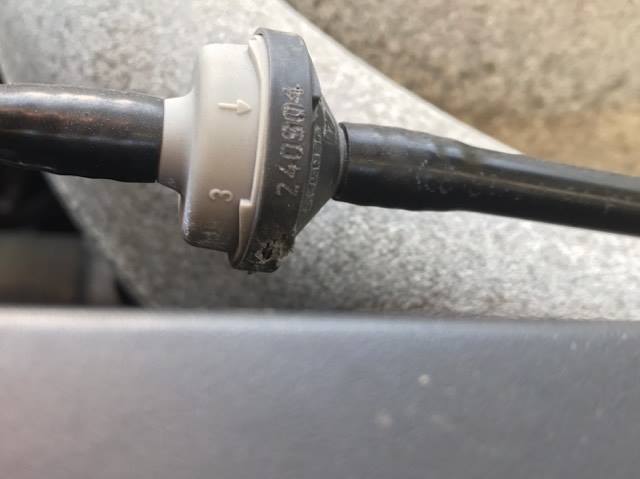

As for the P0174 code, I checked "the big three" and the pcv isn't cracked and the o-rings look good, but the grey part in the brake booster hose is falling apart (pictures attached). I just ordered one online and will replace it next week! Hopefully that will fix my engine light, if not I'll replace the pcv and o-rings for good measure. My dad's friend also mentions that that could be part of the crunchy brake issue too so we will see.

morgy, yes, your brake booster hose is what is most likely causing your CEL light. Keep in mind that the CEL will not go out immediately unless you reset it. If you need help on resetting the CEL, let us know. Easy to do. Otherwise, you will need to drive the car normally and on the 6th start, if your vacuum issue is clear, the CEL will go out on its own.
