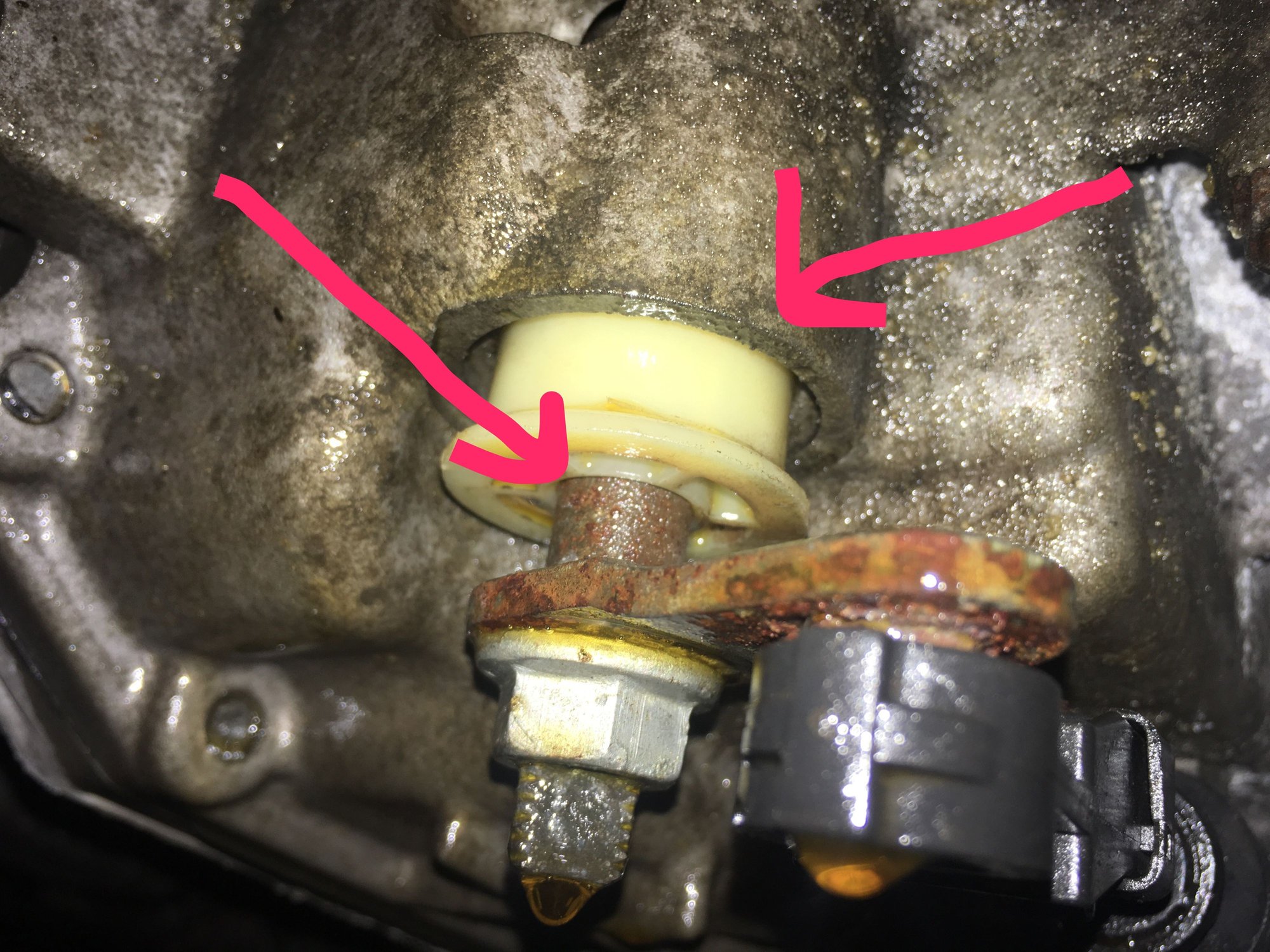

with another person in the driver seat...with engine running and foot on the brake.
go under the car, remove the 3 bolts holding the gear selector cover. disconnect the shifter cable and manually try shifting the car.
(ignore red arrows)
