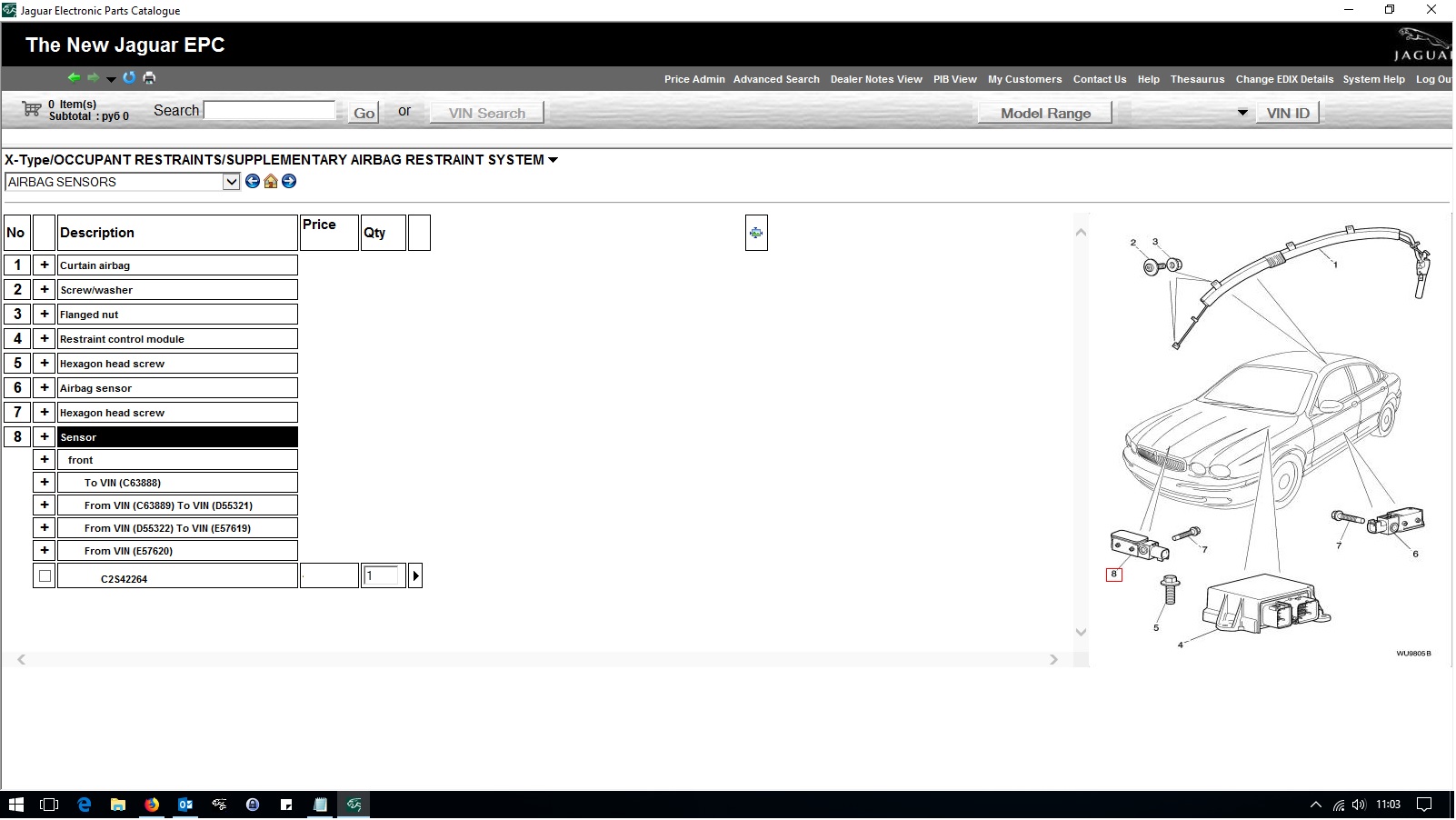

Is this the one - item 8?
Front crash sensor for the Supplementary Airbag Restraint System. Located underneath the bonnet catch panel.
Attached Thumbnails Collision/crash sensor replacement?-crash-sensor.jpg

Could be 6 I think as well. Side, rear, front crash? Not listed.

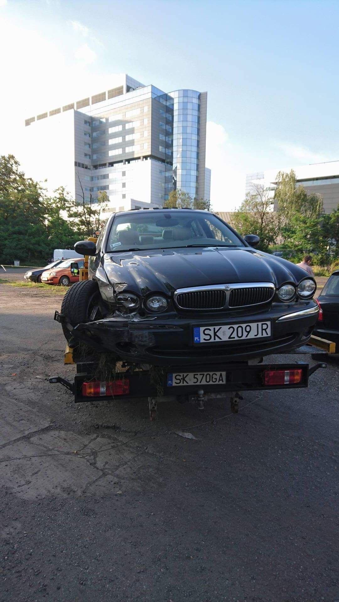

The Jag was hit @ the front right side, last year (pls see the pic attached). Ever since, the immo would come up randomly at least expected moments - sometimes it would trigger once every two months, sometimes twice a month etc - there wasn't any behavioral pattern, just pure randomness. The funny thing is that it was always enough to connect the computer and erase all fault codes for this issue to be fixed, but you know, it is sometimes hard to find someone with one available at a given moment. Last week it was the first time that the inertia switch has fixed the issue.
We suspect either the front sensor or the inertia switch, would you say it is worth replacing them both? Does not look like an expensive part to replace.

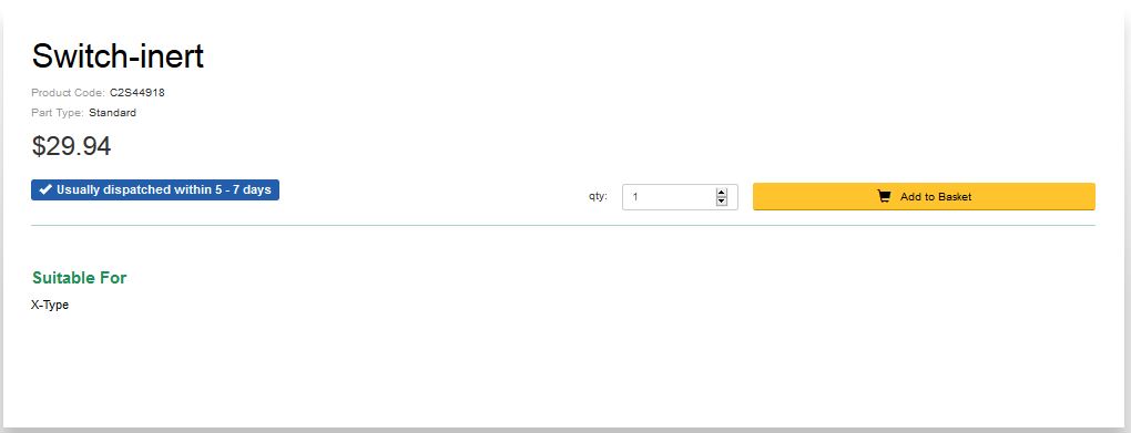

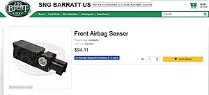

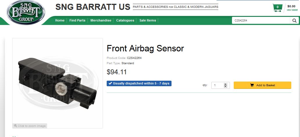

SNG Barratt a forum sponsor stocks them. Don't forget to ask for the forum member discount.
Attached Thumbnails Collision/crash sensor replacement?-front-sensor.jpg   Collision/crash sensor replacement?-switch-inert.jpg
