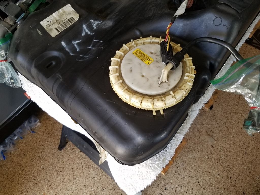

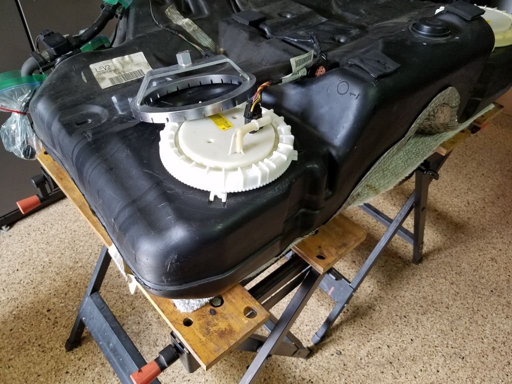

Floor on mine had been butchered. I'm a bit OCD, so I removed everything (not too hard) and had the floor repaired with factory parts.
Removing the interior is required before welding in the new floor.
Removing gas tank if required for EVAP repair isn't difficult, Prop-shaft, exhaust, gas tank. I think the rear subframe had to drop a bit. Very doable at home.
The fuel pump ring was badly damaged due to PO using a chisel or something. New rings, new pumps and a borrowed ring tool and it looks like new!
Cracked - nasty
Cracked - nasty
Easy to install with good access and proper tool.
Just putting this out there to show there is an alternative to cutting big holes in the car!
HTH, Dave
