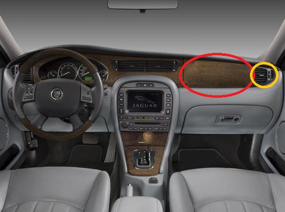

I have the same behind the wood w/passenger_airbag or the vent next to it. Can someone advise how to dismantle those 2 pieces?

I attach a picture to show what I want to dismantle.
Please help!
Thank you.

According to the pictures in JTIS, it looks like the woodgrain finish panel (over the airbag) just pulls straight out and is tethered to the dashboard. The right-hand vent is held in place with two screws that are visible when the finish panel is removed. Since the woodgrain finish panel blows off whenever the passenger-side airbag is deployed, I assume it should come off with some gentle prying.

you mean it is not held in place on any side? wouldn't it hit the passengers face when the airbag deploys?

I took them off.
I started with the piece arround the clocks + central vents. comes off much easier than the airbag part. they have different clips. it helped to take off the big piece first because then i was able to use some tools to pull the airbag piece out (the clips are much firmer not gentle ) pulling from the left side. it does not hit the passenger when airbag deploys because it has retaining belts and it is pushed on the dashboard. the vent comes of only by 2 screws.
Not solved the rattle but at least now I can fancy swapping the wood with carbon when I feel like a racer... provided that i buy the carbon trim in the mean time.
