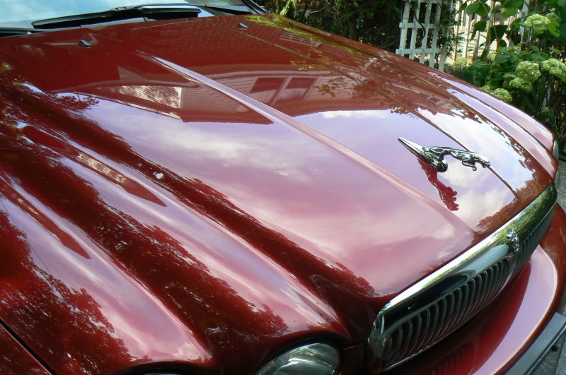

I've had my Porter Cable 7424XP random orbital buffer for about a year.
Owning a black Lexus ES350, I used it weekly on bird droppings and paint sap.
Thankfully, I no longer own a black car.
Way too much work.

First step is always McGuires clay bar for me. I like how it removes pollution from the
paint and leaves a buttery smooth finish.
I start with Menzerna Intensive Polish and a cutting pad, to remove swirls and light
scratches. I slowly work the Porter buffer from about 3000 to 6000 rpm, then
clear the residue with microfiber towels.
I repeat the above steps with Klausse 2 in 1 wax and a medium pad, then finish
with Klause Sealer and a soft pad.
Pretty fair results for a 2004 Jag. 9 Canadian winters and 60k later, she still
shines up nicely. Not showroom new, but very close.

I didn't go crazy on the time process ... perhaps 3 hours.
Today was a good shady day for waxing.

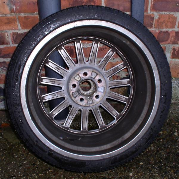

I've found engine degreaser isn't very effective on the inside of the rims and use 'Autoglym Alloy Wheel Cleaner'.
Here's the before............
............and after:
I take the wheels off twice a year to give them a thorough clean like this. Good opportunity to check the inner tyre walls for damage plus brakes and suspension at the same time.

Great job, GGG, on the wheels.
