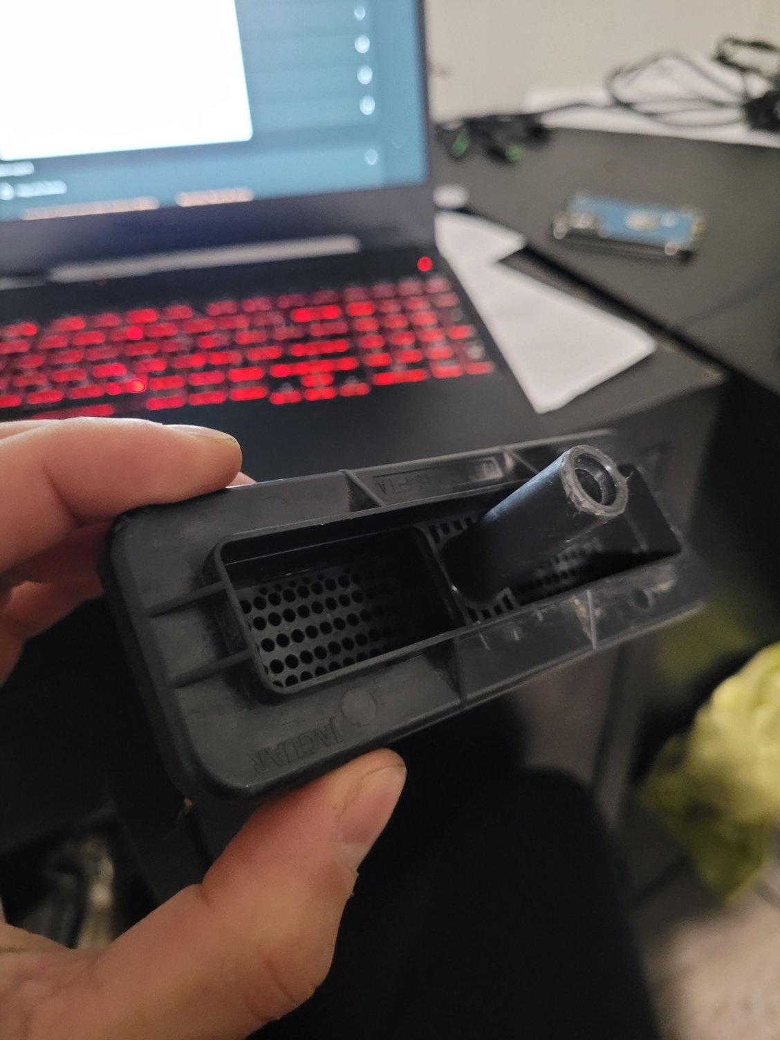

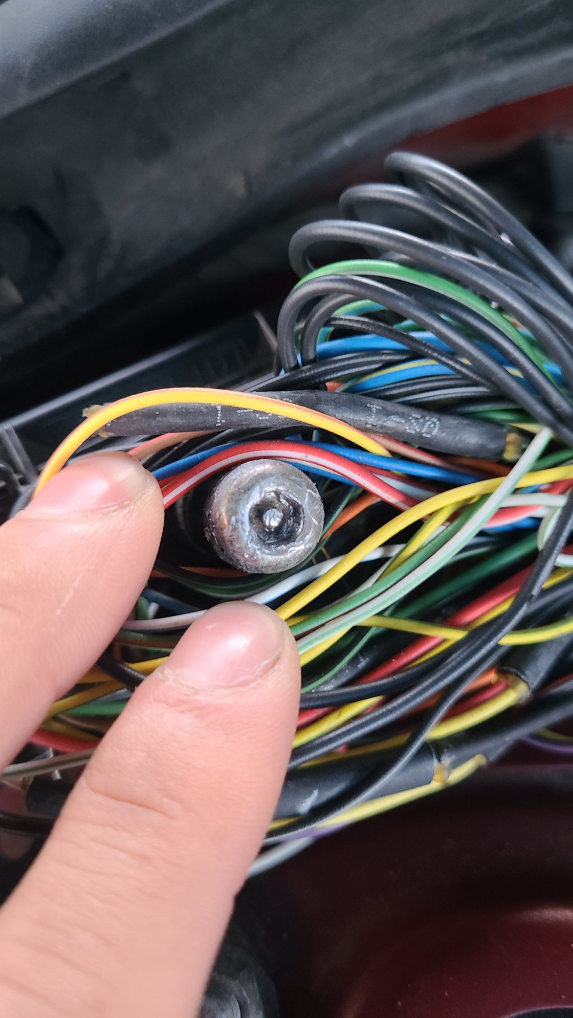

@Thermo yeh it is a wiring thing when I have some wires moved around it works and then when I dont it does not but its very hard to tell which on it is thats causing the issue. also do you know how to take out the bolt the screws into the ecm thats in the wire harness? its got some type of crown washer and I cant mange to break it or pry the tabs.

HELP, I beleive that bolt is a pentatorx bit (5 point star). The bolt is retained in the plug. Why are you needing to remove the bolt from the plug? YOu loosen the bolt and the plug should come out.

Usually the ECM is held in with a security Torx. This has a pin in the center preventing you from using a regular Torx wrench. But they are cheap and readily available. I have set and it was around $10?
Might get a set?

@thermo yeh I did use the bit that fits to take it out but before I used some other things hoping to not get it but this is what happened.

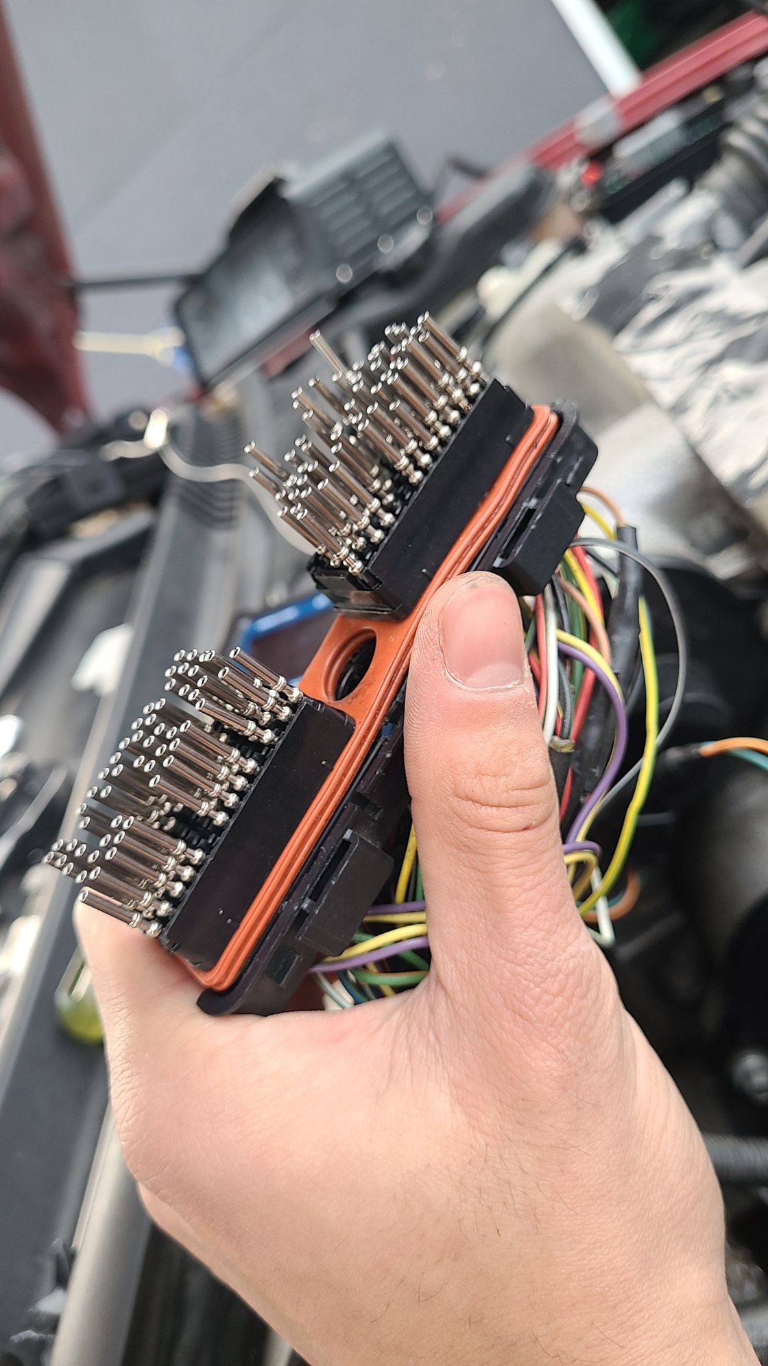

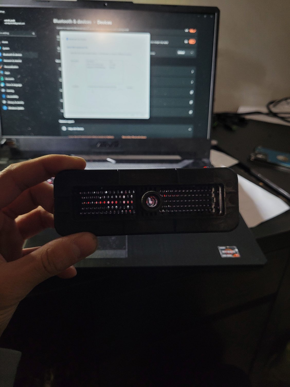

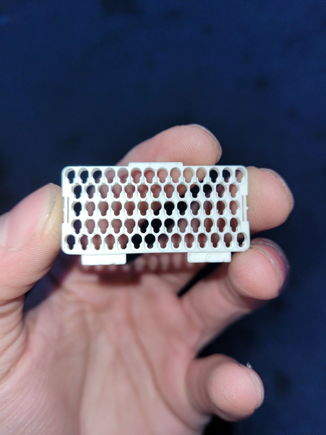

UPDATE: so the connection issue is a wire and its the pin 23 WG, it has a loose connection, so I manged to take off the whole plastic case, which exposes all the wires, and seen in the pictures below
the pins are not even, so I got all the pins evened out and then went to put it back together. this is where the issue starts, there is a white plastic housing that separtes the pins, it has 3 tabs one on the top
and 2 on the bottom. there are 2 of them for each side of the pins one of the side the bottom parts broke off when taking it out. the other one is good but now I cant get it to fit back into the housing.

You can remove the center bolt and I did replacing it with a normal Torx after I screwed up the security one! I just could not get a decent look at the bolt and I had the security bits but simply did not know that was what was needed until it was too late.

huh? my ecm was fired I ordered a new used one.... I taking about of to get the pins back into the 2 picture the plastic housing, there is no communication cuase of a wire which i am fixing rn.

Help, I have never torn a connector like that apart. The best advice that I can give you is to line up all the pins with their respective holes and then wiggle the white plastic piece back and forth as you slowly push it back into place. Not the fastest way, but it should allow everything to line back up and get it so you can insert the plug.

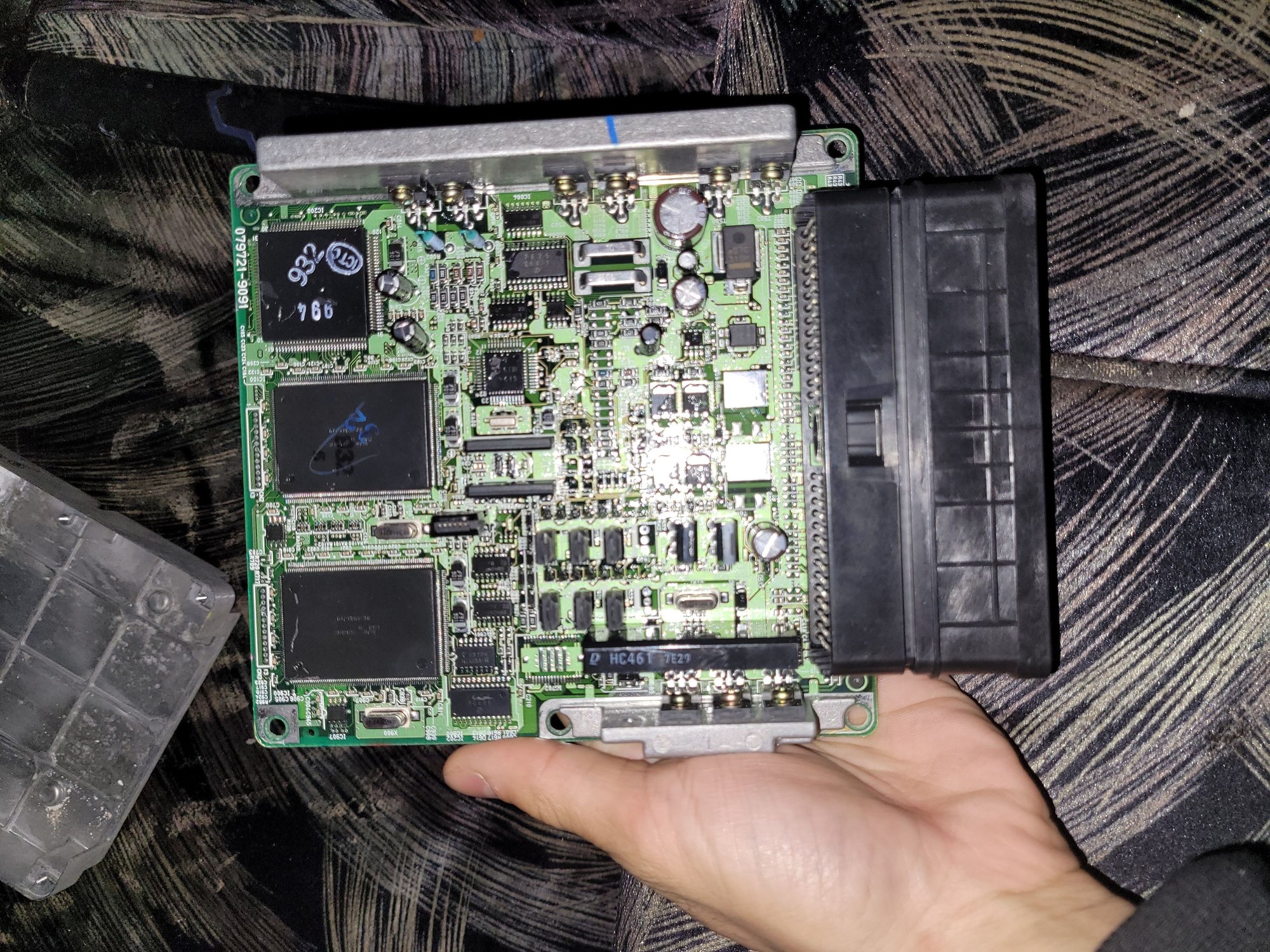

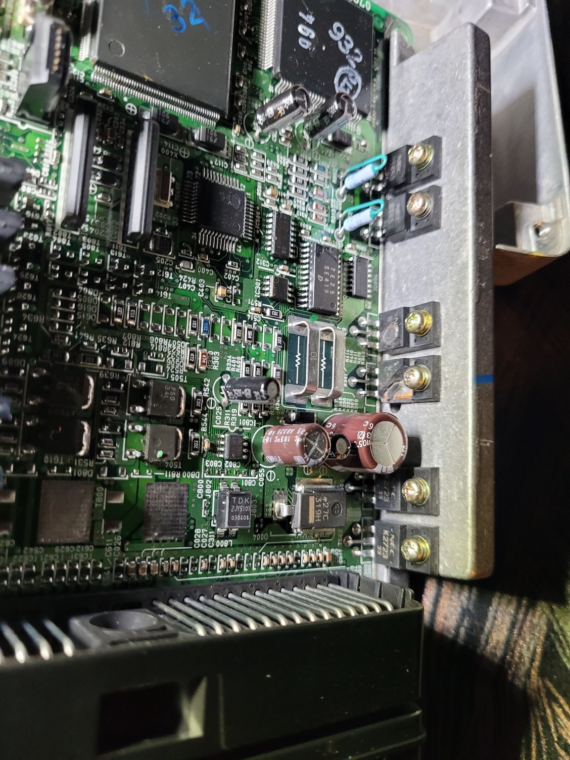

The thing is on my old ecm there is a capacitor that blew and I am not sure why it blew up. let me find a picture one sec

these are the pictures

I believe the caps on these don't tend to blow and I'm sorry but other than very careful replacement of it I've no ideas.
