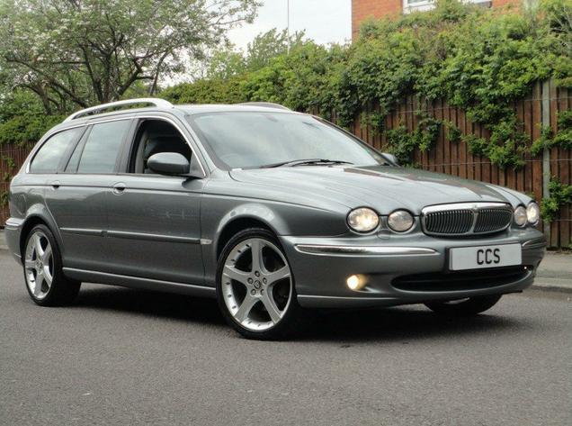

I posted in here a few weeks back mentioning I was looking for an X Type, and today I bought it. I'm quite pleased with it, 2006 X Type SE Estate (Sportwagon) 2.2 Turbo Diesel. It has a nice shade of grey paint, and a full grey leather interior. I drove it home 110 miles and it was very nice indeed. It's also rocket fast!
There are two little issues though maybe you can help me with:
1) The rear parking sensors aren't working, I've checked the fuse.
2) The electro chromatic rear view mirror doesn't seem to be working. On my XJ8 a little green light would be lit if I switched it on, there are no lights here.
I've put a couple of pics at the bottom, but they are from the Dealer's website so aren't great.
Thanks Guys!
Stu.

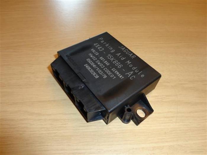

I've checked the sensors like Thermo suggested and I can hear them making a high pitched whining sound, so I guess it's the speaker? Is there a wiring diagram for the 2005 X Type Estate where I could follow the wiring and replace the speaker with another? I'm thinking any small speaker will do?
Thanks, Stu.

Stu, all that I can tell you is to access the spare tire area and you will find the parking aide computer there. If you look, you will see a red/blue wire and a blue wire running off to a corner of the car in the rear. Follow those wires. Those wires will lead you to the speaker.
As for making "any speaker work", not quite so fast. once you find the speaker, pull the speaker from its mount. If you look on the back of the speaker where the magnet is, you should see some writing there. Hopefully you will see something to the effect of "8 ohm" or a number with what looks like an "o" that has feet (this is the ohm symbol). You have to match up this resistance with the same resistance speaker. Going with a lower resistance speaker can lead to damage to the computer. Going with a higher resistance may or may not lead to a quieter tone.
If in doubt, take a picture of the back of the speaker and post it here. I will be able to make heads or tails of it from there.

Here is what type of parking sensor system I have, it is the newer type for the 04 & up models. I have found the OEM speakers on the website I lifted this from for £6.00 which is very cheap.
This unit has 3 plugs coming out of it.
